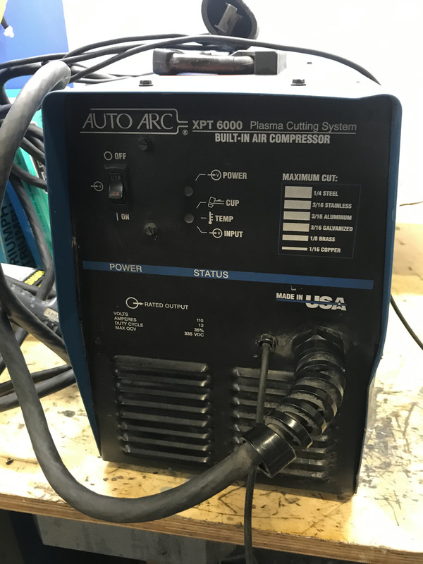

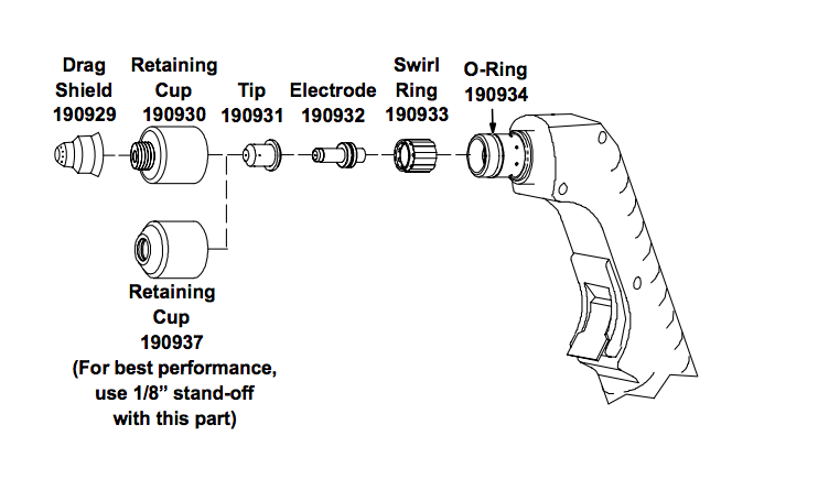

Good timing. I bought this AutoArc XPT 6000 off CL a few months ago for little over $100.  Seemed to fire up so figured worth the risk at that price.  I think it was originally made by Miller.  It's only 110V and has the compressor built in.  Very long leads.
Anyone ever seen one of these?  I've googled the part numbers for the torch consumables out of the instruction manual but haven't gotten anywhere.  Anyone familiar with the consumable parts on these things to know if there are generic replacements available, or am I SOL?  I really haven't used it yet other to make it creates an arc, but would like to give it a freshen up for when I need it.
