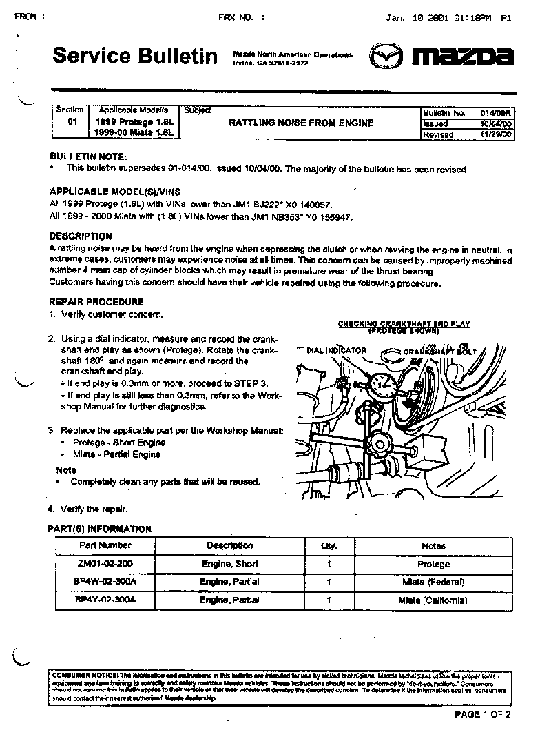

I forgot to mention the thrust bearing in earlier posts. Depending on the year I believe 99-00 and in a specific serial number range there is an issue with the thrust bearing. It has likely already been dealt with in your case based on the mileage. http://www.miata.net/garage/tsb/tsb014_00r.gif
