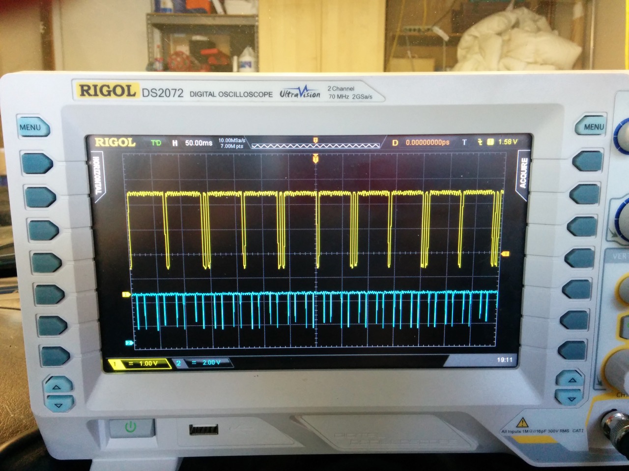

Even NB Miatas don't run 24 tooth wheels.  4 teeth on the crank (unequally spaced) plus 3 on the cam (so that you get 1 tooth in one phase and 2 teeth in the other).  Does sequential injection just fine, either with OEM or megasquirt.
(10 crank revolutions in that image)

So?  That doesn't make it a 15-degree wheel. :)  All the timing is driven off the four teeth on the crank wheel, the sensor on the cam is just there so it knows whether TDC is for #1 or #4.
In principle you can use a single sensor on the cam with twice as many teeth on it as the crank has and correct for the belt stretch based on RPM like Paul mentioned.  AIUI this isn't good enough for doing proper misfire detection, though, and that's why OEMs use crank sensors instead.  Mazda used the diagram above for all the 1.6 cars (90-93) and the first couple years of 1.8 (94-95), but midway through 95 they needed to add OBD2 with misfire detection, and they added a crank trigger just for that (different pattern from the NB cars though).
I suspect it's also easier/cheaper to get the proper resolution on the crank because the pulley is larger.
