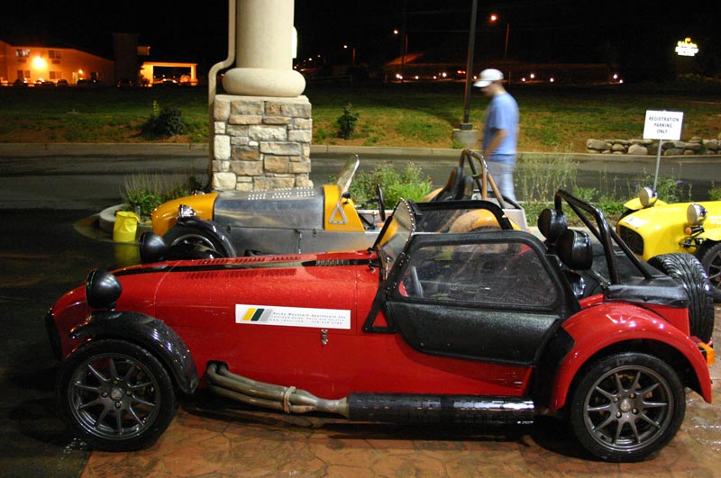

A big key to the look of the car is the nose cone shape. The Lotus/Cats also have an angled side to the cockpit, like SkinnyG's car. Headlight placement varies quite a bit, Caterhams have them high on stalks and a lot of Locosts put them low and beside the nose. Square or undersize headlights also make a Locost look dramatically different.
G, what does your car look like in plan view? When you say you "smudged everything back", does this mean the transition between the cockpit sides and the engine bay sides is still at the leading edge of the scuttle?
SkinnyG
SkinnyG Reader
1/2/10 5:31 p.m.
The transition is still at the leading edge of the scuttle. The crease down the sides has been moved back too. Maybe this picture will help? It's a subtle change, but a significant one - the cockpit on the locost looks way too long and the front way too stubby. Moving this transition back puts things into better proportion.
mblommel
mblommel New Reader
1/2/10 6:19 p.m.
Skinny I think you're really on to something with the placement of the scuttle further back. You can really see it in this picture from Keith's site:
You can really see how much longer the Caterham hood is.
I also think that painting the whole car the same color really improves the aesthetics. The headlight placement also seems to play a big part, as does the wheel/tire combo. The all black trim, carbon fenders and other bits also make a difference.
BTW I've always thought Keith's car is pretty sweet too.
SkinnyG
SkinnyG Reader
1/2/10 7:32 p.m.
I just checked the Book locost drawing, and a Lotus Series 2 drawing, and the cockpit sides (seat back to scuttle) are about 10" shorter on the Lotus! Gasp!
Keith
Keith SuperDork
1/3/10 12:11 a.m.
Yeah, I'd never noticed the scuttle difference until I parked beside that SV. It's fairly dramatic. My car looks okay in isolation though It's also improved since that picture was taken, I built another windshield that was about 1" lower and it made a huge difference. I also put a tonneau over the "trunk" and that had a big effect. Little things.
I need to check on the Westfields. They're very closely related to a Locost in design (VERY closely, based on the look of the bare frame), and I'm wondering where the scuttle is on those. I'll have a look on Monday. I seem to recall it's about halfway between a Locost and a Lotus.
Thanks, Skinny. That's what I thought you meant. You'll have less footwell room in your car than in a Locost. Maybe not a problem for you, but it's always the tightest part of fitting into a Seven.
Now that I think about it, the scuttle on my Locost is at the back of the engine compartment, not at the front of the cockpit. The body sides are tapered there - see picture below. So I could feasibly build a new scuttle that starts where my current one ends, and get the long nose look. If I do another round of modifications, maybe I'll give that a shot. I have some plans that may involve a new hood, and that would be the time to do it.
Polished vs painted sides depend on personal opinion. I like the raw metal - obviously. That's just how a Seven looks in my head.
