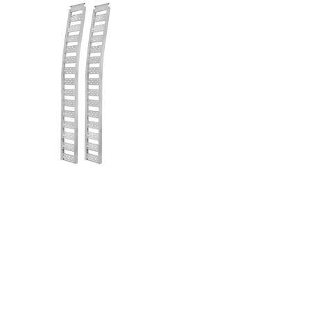

I just bought a pair of these from Tractor Supply. The photo is misleading, the price is for a PAIR. Capacity of EACH ramp is 750#, so for $100 you get two nicely made, lightweight, 90 inch curved aluminum ramps that can support 1500 pounds.
They are a bargain.
http://www.tractorsupply.com/en/store/farm--ranch-pair-of-arched-aluminum-loading-ramps-20-in-w-x-90-in-l

But the Tractor Supply aluminum ones are a much better solution.

SVreX wrote: But the Tractor Supply aluminum ones are a much better solution.
They also nest onto each other very well for storage, and you can carry both with one hand.
