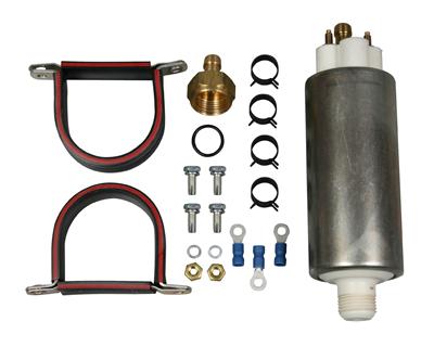

Early 944 pumps look about the same as those Airtex inlines, yes?

Secret_Chimp wrote: Early 944 pumps look about the same as those Airtex inlines, yes?
Yes
I think they are made by Bosh if I remember.
I have had great luck with Walbro pumps here are the measurements for there's

I've just finished installing an inline Airtex pump. There ended up being a perfect spot against where the floor humps up before the axle for the rear seatback.
