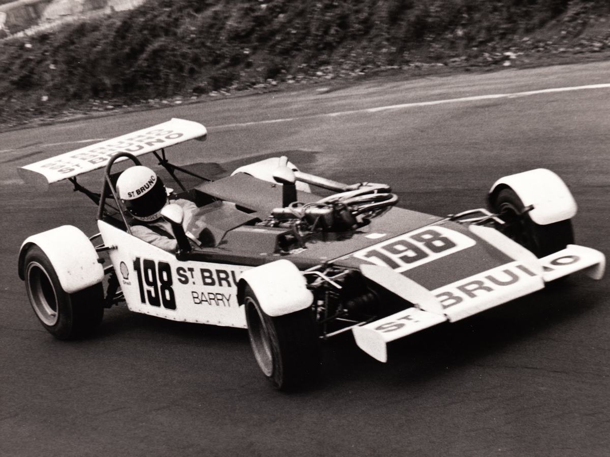

This was at Lagun Seca a few years ago.

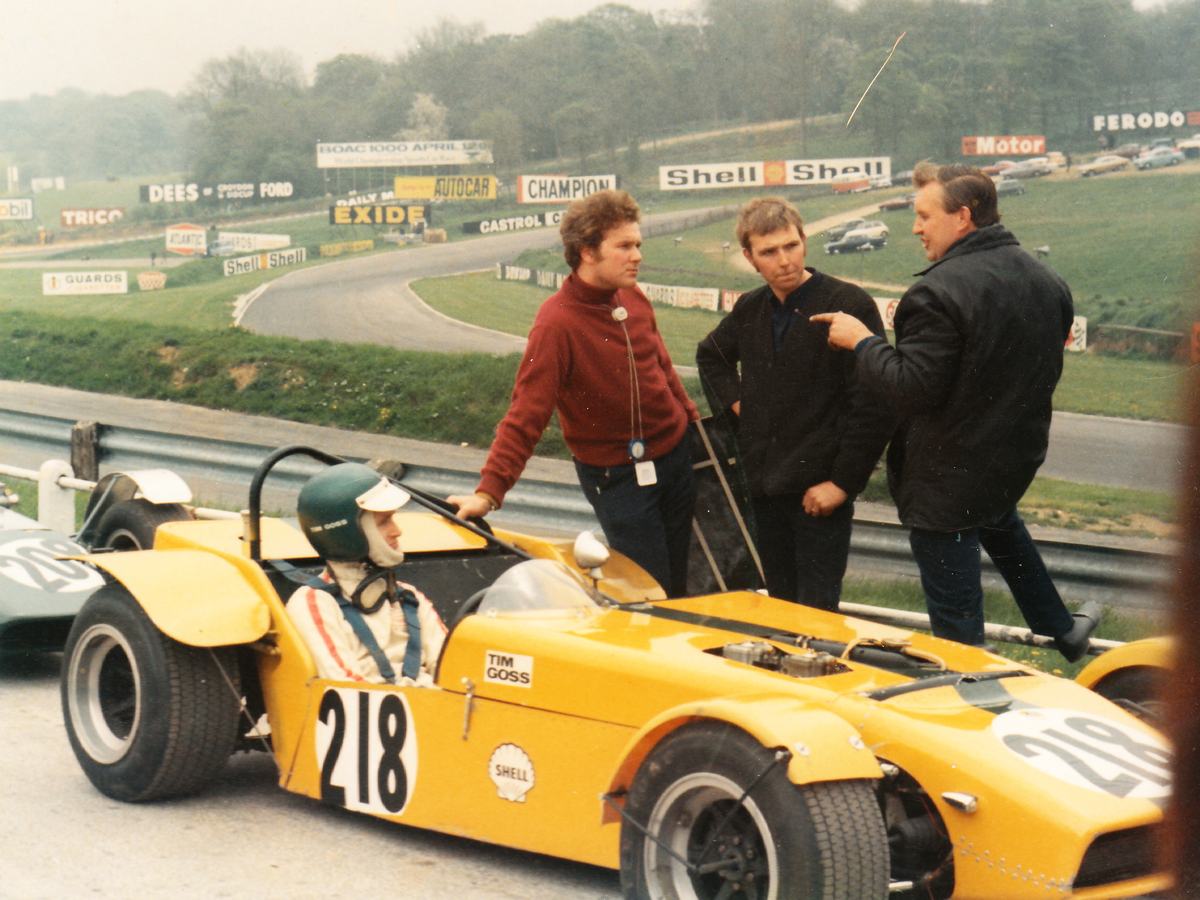

The next batch are actually '750 Formula' cars I mentioned earlier.  these are offshoots of the old Austin 7 specials and are generally similar to Clubmans cars but smaller.  Note they are only allowed to use a single chock carb, hence one shot showing a Weber sidedraft with only one trumpet, that's because they are only using half of it.  Note these things have a min weight of  just over 800lb's wet minus driver.
