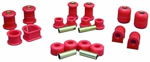

I'm pretty sure the bushings and shocks/struts on this 87 are 26 years old or so. Anyone out there tried the Prothane bushings set? Prothane 18-2008 kit
Worth it? Noticeable difference?

I had them on my car, very noticeable difference from stock, nice upgrade. Definitely recommend it.
A few months later I added Konis and ST springs and sways. If I did it again I would trade the ST springs for something with a higher spring rate, not much suspension travel left even with cut bump stops.

good stuff... I wish the new management hadn't screwed Sarge like they did (guy who paid for them to tool up to make them)... but if I had another mr2 they would be on my list of upgrades.
I do know that some people had some issues with the fit of the steering rack bushings... but that was 10+ years ago so I don't know if that was fixed or not...

Ah yes the steering rack bushing, almost forgot about that.. Not a big deal though and certainly not a deal breaker.

The last set I bought was about 5 years ago and the rack bushing fit good.

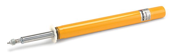

Koni.

I dd'ed my aw11 for a few years with the prothane set. I'd recommend them as well. Great upgrade from 20+yr old rubber.
Also - Koni.
No, really just buy the Konis. There really isn't anything else that is as-good OTS. Most of the "full" coilovers made for the chassis are Taiwanese crap imho.

Sounds like these then:
Koni on Tirerack

I've used these on a couple of cars, including my ITA car I used to own. No issues at all. And +11 Gazzilion on the Konis. They are the only shock short of something custom made I would use on the MR2. Most off the shelf shocks run too much compression and make the car nervous at speed, the Konis on the other hand are a joy. Everything a shock should be!

Keep in mind that there are 2 different shocks for the rear, depending on the build date. I'm pretty sure all of 87 is in the later set, but do look that up before buying 1K worth of suspension stuff.
These people: http://www.alamomotorsports.com/koni/koni_shocks.htm aka cyberauto.com , will drop ship you some Koni's at a really good price. I don't see much listed for part numbers on there right now, so you'll have to call them. Tell them I sent you.

I'll offer a counterpoint on poly bushings: They're better than dead OEM bushings and worse than good OEM bushings. Suspension loaded up, they're fine, but they're sloppier on-center than OEM rubber bushings.
Most MR2 people have never experienced what they're supposed to feel like with good bushings and perceive poly as an upgrade. They're certainly cost effective.

Tyler H wrote: I'll offer a counterpoint on poly bushings: They're better than dead OEM bushings and worse than good OEM bushings. Suspension loaded up, they're fine, but they're sloppier on-center than OEM rubber bushings. Most MR2 people have never experienced what they're supposed to feel like with good bushings and perceive poly as an upgrade. They're certainly cost effective.
Agreed on both counts. Last time I tried to buy OEM bushings they could only sell them with the control arms ($$$). Poly is really are only affordable option.
