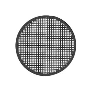

I've since added a metal cover to the sub to protect it:

15) Subwoofer metal cover $10 (Amazon)
