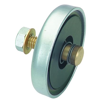

Rodan
Rodan HalfDork
5/5/19 9:31 a.m.
Dusterbd13-michael said:
Where is the ground?
This.  Sometimes it's hard to get a good ground when working sheet metal.  An alternative to welding on a piece of metal is a magnetic ground post.

Crackers
Crackers Dork
5/5/19 11:38 a.m.
My first thought was also a kinked torch lead but I'll second ground issues.
When doing bodywork you want your ground attached pretty much to the panel you're welding. Especially if it's a pre 90's car.
Like Duster, I've also welded small bits to a panel for a good ground. Can be any size/shape just no thinner than the base metal you're welding. Hold the new piece with the ground clamp itself, buzz it on and move along.
