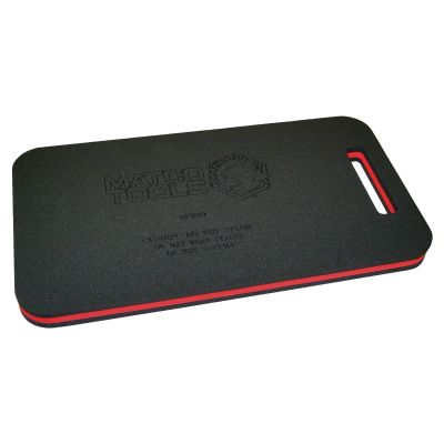

The tool companies make these foam pads and sell them for around $30. You could scrounge something similar for under five bucks.
Makes dropping the tranny a breeze- I litterally let it drop and watch it bounce before pulling it out on the pad. Makes resting it on your chest relatively painless too when you're ready to bench press it back in. At least on a Miata. No way I'd try this with a TH350!
