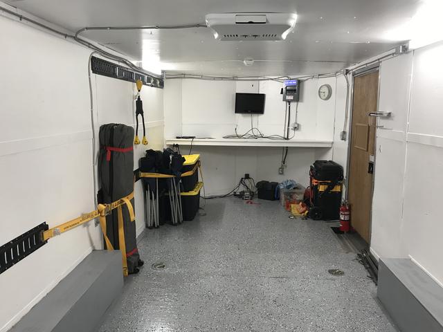

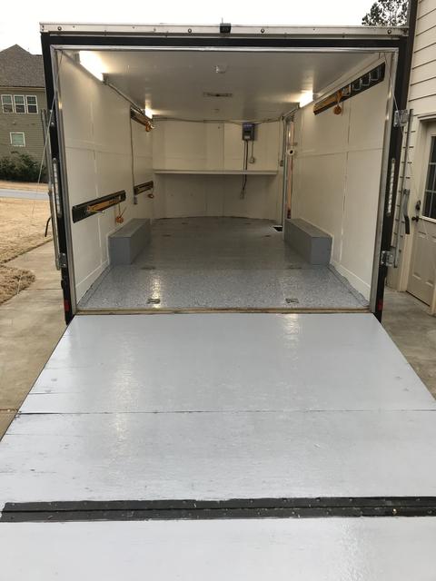

I started with a basic used 20 footer with upgraded axles last winter, and spent about a week turning it into what I wanted. It doesn't compare to those fancy aluminum $30k trailers you see on Rennslist, but mine's "a bit" cheaper, and fits well with the E36 Track Rat.
- Stripped the plywood off the walls and ceiling and insulated both, painted all white
- Installed RV power set-up, with basic breaker panel. 30 amp plug on outside of trailer
- Install multiple power outlets in front and along walls. I used MC cable as it was easier than trying to drill all the studs and burying it in the walls. Doesn't look as nice as buried wires tho
- 120V LED Lights
- 15,000 btu AC / heat
- Cheap Rustoleum Epoxy garage floor on floor and ramp. The ramp has lots and lots of grit in it, that Epoxy floor is slippery
- Installed a cheap HF winch
- Installed a NT electric jack
- Basic work bench in the front (I tow with a 4.7L Tunda so weight is a concern)
The previous owner installed 4 wireless cameras, and I can tell you they are junk. I don't know if it's my truck or what, but the rear one is all but useless.
