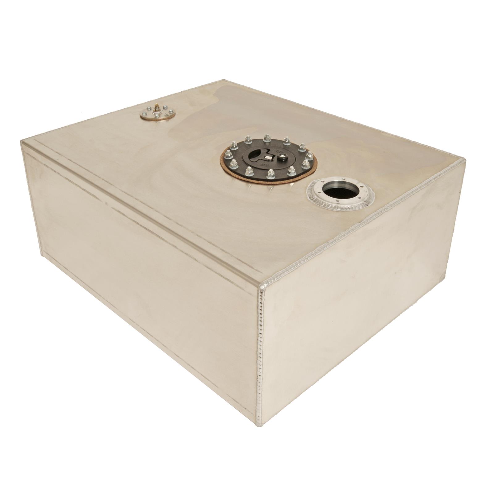

How about a 10gal, race style, fuel cell mounted to the truck bed?
Sample
1988RedT2
1988RedT2 MegaDork
5/22/25 12:10 p.m.
Fuel cell?
https://static.summitracing.com/global/images/prod/xlarge/sum-295220-s_xl.jpg
