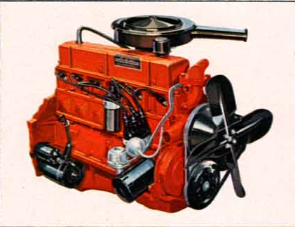

If we're staying inline, then this should have been suggested:
Hey, they put 'em in Camaros and Firebirds...

I'd have to use the OHC Sprint 6 in that case, because Pontiac
