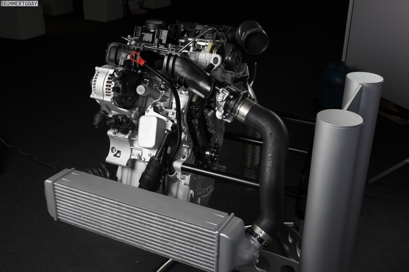

I could further postulate that the shorter deck heights of motorcycle engines might make using them to be more acceptable... but your post got me to thinking some more. BMW uses chains in pretty much everything designed after the 70s, and they have a new 3-cylinder engine...
Nope, looks like there's a timing belt sitting there on the crank end of the engine..

ransom
ransom UberDork
11/29/13 11:52 p.m.
Knurled wrote: Nope, looks like there's a timing belt sitting there on the crank end of the engine..
You sure? I feel like I'm looking at chain and guide...
Yup. I see a chain too - and that's the flywheel side of the engine... I sure hope those puppies don't have tensioner or guide issues... (on a BMW? Ha!!!) ...as those will be hell to R&R...
Berk timing chains. I'll take a belt every berking time... at least belts are designed to be service items. Chains rarely are.

Ian F wrote:
Yup. I see a chain too - and that's the flywheel side of the engine... I sure hope those puppies don't have tensioner or guide issues... (on a BMW? Ha!!!) ...as those will be hell to R&R... Berk timing chains. I'll take a belt every berking time... at least belts are designed to be service items. Chains rarely are.
Well, here's the link where I found that: http://www.bimmertoday.de/2012/09/18/bmw-dreizylinder-motoren-2013-technik-details-benziner-diesel-lopez-interview/ (Haben Sie Deutsch?)
And the direct image link to the (HUGE) fullsize copy is here: Big picture!
And... yeah, on closer inspection and playing with contrast, it might be a wide, flat chain, but it's damned hard to tell. And if those a guides, why are they not curved to prevent chain whip?
Chain vs. belt is an old discussion and people rarely change sides. I'm merely curious on the feasability of a "coarse" engine like a three (or a two or a one!) with a looooong OHC timing chain. If that's a chain, I wonder if being that close to the big ol' damper mass known as a flywheel (no doubt a dual-mass unit as well) would help things.

Ian F
Ian F UltimaDork
11/30/13 5:11 p.m.
Knurled wrote: And the direct image link to the (HUGE) fullsize copy is here: Big picture! And... yeah, on closer inspection and playing with contrast, it might be a wide, flat chain, but it's damned hard to tell. And if those a guides, why are they not curved to prevent chain whip?
I'm still not sure we're looking at the same picture. That is in no uncertain terms a chain and the guides are definitely curved...

Knurled
Knurled PowerDork
11/30/13 7:13 p.m.
Yah, on much further inspection, those are guides.
Weird. I'm not used to seeing guides that don't have a massively pronounced curve.
This should be an interesting engine. BMW is claiming upwards of 225hp from 1.5 liters. It looks like they are going to a modular 500cc-per-cylinder design for threes, fours, and sixes.
