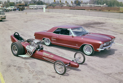

The great Tommy Ivo towing his FED with his Buick Riviera.
