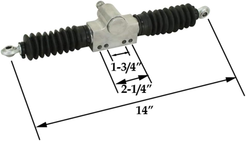

I looked over all your suggestions and the one knurled showed may work the best. The problem with most of them is the tie rods mount to the ends of the rack instead of the center. It makes my tie rods much shorter. Because my front suspension and front steering will be pivoting on different planes it can cause bumpsteer. The easiest way to eliminate it is to use long tie rods that minimize the angle changes of the tie rods as the suspension cycles. I have one of those Empi style racks that I was going to use before I understood the negative effects it can cause. They can also be twitchy because they respond so quickly to any input. I did find another style that may work well at Speedway. I've got to find out what the ratio is though. I'm going to look more into the fox body rack too but I think the sprint car style may be easier to mount. I had hope to find some vehicle that mounted the tie rods in the center (equal length) and had the steering shaft input to the driver side, both on the same side of the rack. Doesn't seem one exists and I don't know if it's possible to "flip" one part of the rack to get them on the same side.
