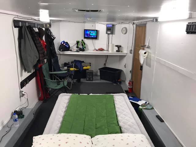

I did just what you are asking about.  I started with a used 20' Pace V nose with upgraded axles.  Cost me about $3,200 IRIC.  Stripped the wall panels down and insulated the walls and ceiling.  Put 1/4" plywood on the ceiling.  Painted.  Then did Rustoleum Epoxy garage flooring.  I bought the cheapest low pile carpet I could find, and roll that out when in "camper" mode at the track.   Installed a 30 amp RV outlet on the exterior, and wired up a breaker panel.  Ran multiple circuits around the trailer (I ran it surface mount in MC Cable, as it was going to be a LOT of work to bury it).  Installed a few 4' LED lights.  Removed the vent unit on the roof and put in a 15k AC unit with heat strips.  Work bench in the front with a TV above it.  Cheap HF winch, and a 12V automotive battery.  I can backfeed the panel to feed the LED lights with an inverter if I don't have it plugged into shore power.  E Track down both walls.
I just sleep on a decent quality air mattress.
I probably have a bit over $5k in it.  The only thing I'd really like to add is a window, but I'm worried about security as I stays in a storage yard. Well, and an exterior light by the door.
Before AC and one set-up in camp mode.  I guess I could have picked up a bit first.

In reply to wake74 :
Yep, we're on the same page. That looks great!
