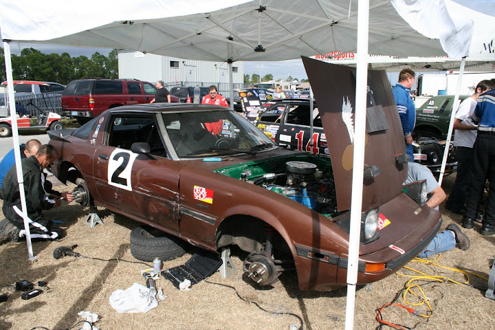

I would recommend the 5.0 swap in the FB RX-7 or a 5.0 or 5.3 in the FC.
We have a 5.0 FB Lemons car. Very easy to work on.
