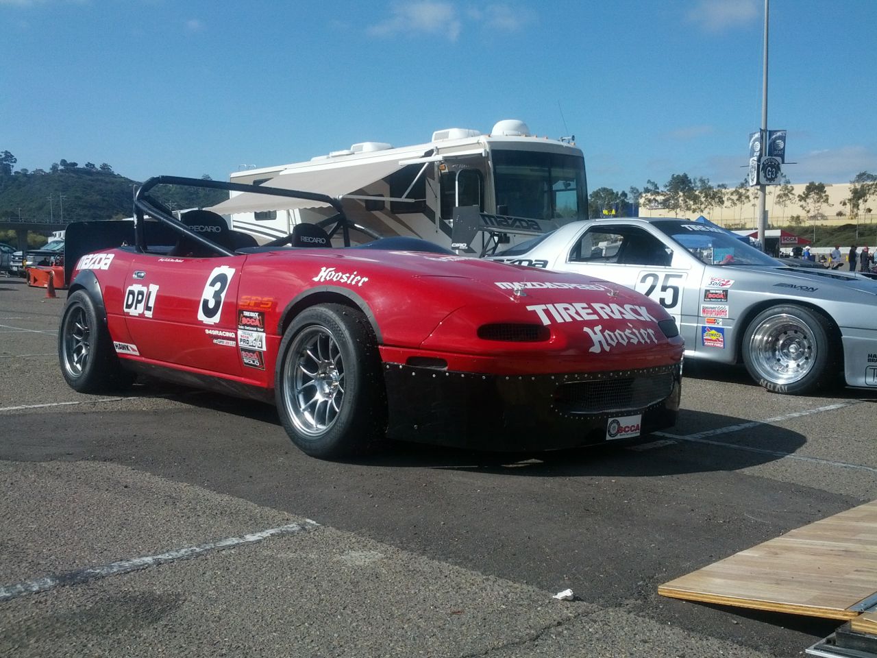

STS is not far enough, the caged Miata without a body is too far (sort of).
I'm daydreaming of how light a Miata would be if it had the equivalent "stuff" as a 7, including w/s and wipers.
No heater or a/c, lighted bumpers, gutted doors- meaning cutting the door beam some. No air bags, etc.
I remember an article in a Miata magazine that someone did it on an NA, and got it really light. Again, we are talking beyond Street Prepared lightening, but still no body would see it as non-street legal.
