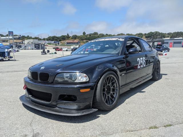

+1 on the E46 M3.  Personally I don't like the semi-trailing arm rear suspension in the Z3/M coupe cars, I'd rather have the E46 even if it's a little heavier.
As far as SMG goes, my M3 originally had one.  It's interesting in that it's "automatic" in the sense that you don't push the clutch pedal, but you really need to drive it like it's a manual.  If you try to drive it like an automatic (put your foot down for the torque you want and ignore the transmission) it winds up being really herky-jerky and it shifts like a 16-year-old who's on his 3rd lesson with the manual.  You need to predict when it's going to shift (or put it in manual mode) and lift off the gas a bit as it does so.
In general I don't think I'd recommend one unless you have some kind of physical impairment that prevents you from operating a clutch pedal.  SMG cars are cheaper by about the same amount as it costs to convert it to a 6-speed manual, so you won't save much (basically just labor) and the resale value likely won't be as good if it's converted.
I bought mine explicitly to turn it into a race car, so it was going to get an E36 5-speed anyway.  The E36 box is lighter, stronger, and you'll never use 6th gear on the track.
