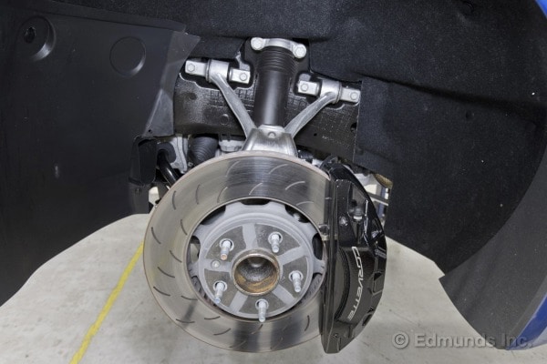

C5, C6, and C7 Corvettes all do. Same for the rear.
I don't know about the previous generations.
mistanfo
mistanfo UltraDork
3/23/15 5:52 p.m.
Petrolburner wrote: C5, C6, and C7 Corvettes all do. Same for the rear. I don't know about the previouks generations. But they aren't FWD. Otherwise we could simply include The Answer.
