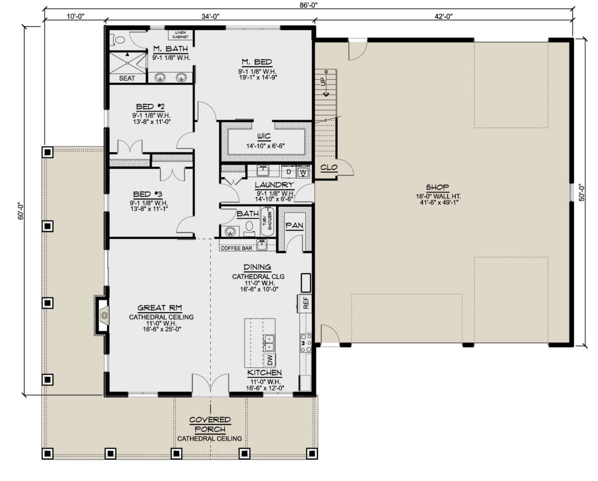

Something like this appeals to me. A nice mix of living and shop space. Right at 2000 sqft living, about 2000 sqft of shop. If I was building it I would probably take the porch on around the rest of the house.

Main Floor for House Plan #5032-00151
I would like y'alls input. What do you look for in a house? In a shop? Do you prefer the shop to be separate from the house? Do you have a set of plans or a drawing of your dream house?

The bathrooms, both of them, seem a bit small.

I agree the bathroom look kinda small, but I can also understand wanting to keep them as small as possible for easier cleaning.
Edit: one comment about the garage shown. The large through-door bay looks like it's designed for an RV.  If that is in the plans, then make sure the space allows for parking with the (assumed) slides out. And be able to walk around the RV with the slides out.
