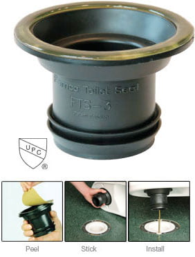

I can't imagine you'd break anything with the shop-vac. Not much to break on the inside of a toilet drain. If it's stuck in the trap a human with intact bones is unlikely to be able to pull it out by hand. Removing a toilet isn't all that hard though. Wax rings are a pain in the ass though. It costs like a whole 4 dollars extra, but I much prefer these, and once I install one I can take the toilet on and off as often as I want.
http://www.fernco.com/plumbing/wax-free-toilet-seal

Josh wrote: Removing a toilet isn't all that hard though. Wax rings are a pain in the ass though. It costs like a whole 4 dollars extra, but I much prefer these, and once I install one I can take the toilet on and off as often as I want. http://www.fernco.com/plumbing/wax-free-toilet-seal
Thank you for showing me this device! We are planning to redo the floors in our bathrooms soon and I was wondering if there is a better solution than the 100+ year old wax ring technology. Not that old technology is necessarily bad, but the few times I've removed a toilet, I could not get the wax ring to seal properly on the first attempt.
