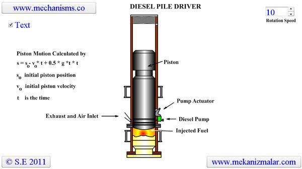

Worked on a side project that was essentially a glorified stopwatch for calculating how much 'stick' the piles have based on the timing of the bangs when pile driving once. It was a pretty neat process.
Short version:
When using a pile driver like the above, you know how much energy is available assuming your fueling is consistent. You also know how much the pile driver weighs. For a given bang, the pile goes down and the piston goes up. Then the piston falls back down and goes bang again.
If you time the interval between bangs you get a pretty decent handle on not only how high the piston/driver went, but how far you sunk the pile. (again, assuming consistent fueling) Given a consistent amount of energy, how far you sink per hit is used to calculate stick.
We were running this on portable phones and tablets with mics. The data from our kludged together app wasn't good enough to certify anything, but it allowed the crews to get a lot closer before getting an inspector over, saving a decent amount of time and money for both the contractor and the county (doing the inspections).
