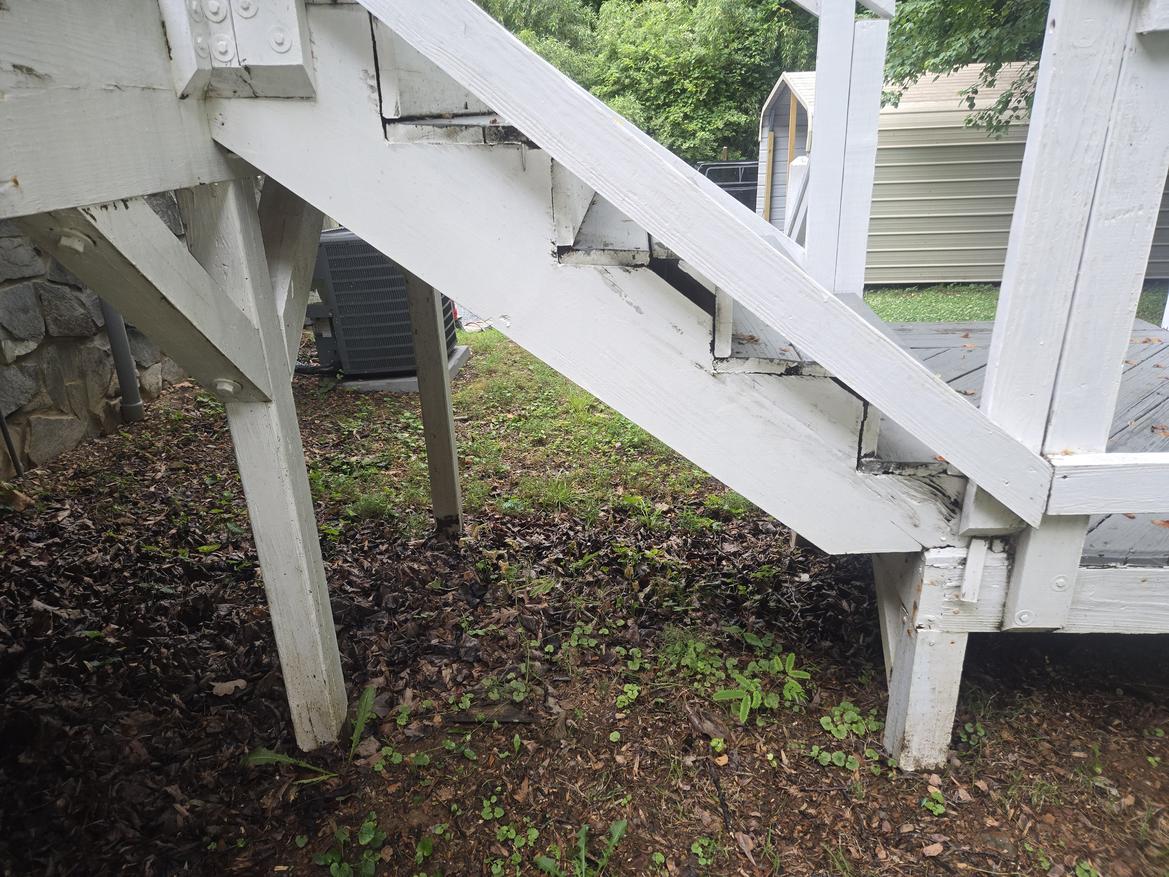

Ill grab pictures in a few, but central north carolina near Charlotte, used pressure treated from Lowes amd was painted with exterior latex since dry, no obvious drain problems noted since the primary rotted spots currently found are the railings and stair runners.

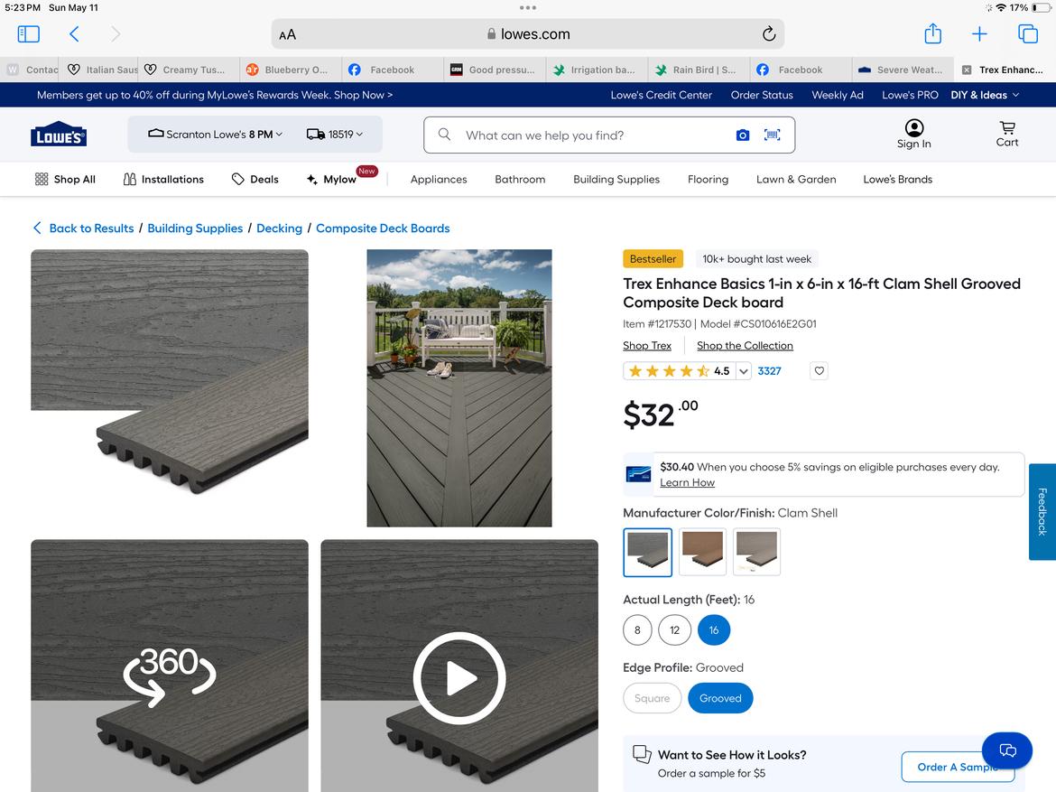

Composite decking. Buy once, cry once, but it will last. A quick search shows $20 vs $32. Worth it in my opinion but still sux that you need to re-do something so quickly.

In reply to lotusseven7 (Forum Supporter) :
It's not the surface I'm having repeat trouble with. It's the framing. Which they don't make composite for yet to my knowledge.

5/11/25 5:52 p.m.
Pictures of my big deck (Giggity)
From the driveway up the sidewalk
The downhill side of the stairs
From the uphill side, you can see the rot on the outside runner on the second flight
Close up of the runner
And the railing on the landing
Overall from the uphill side
I replaced all the stairs and runners 5-7 years ago. All the railing, and some of the deck boards. After pressure washing a few weeks ago the rot was found, and its almost all centered on what I just replaced. However, most of the surface boards are showing their age, except the roofed part.

Looks like end grain rot.  Did you seal the ends?  Not that I would have.

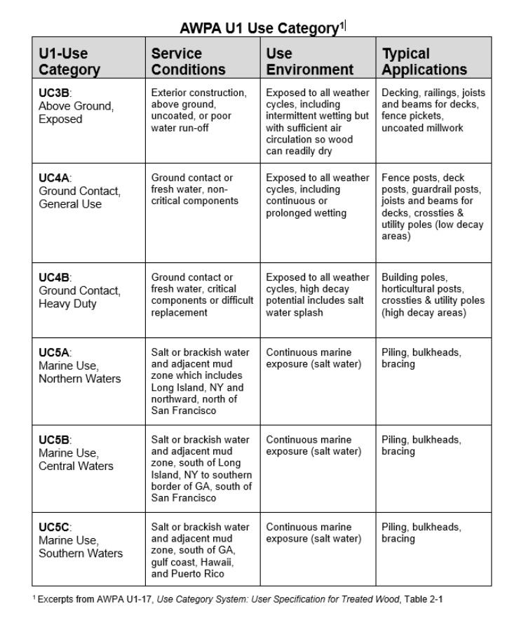

There are several levels of identification on the labels on the end of every piece of PT wood.  I just went in my back yard and picked these two labels off 2 pieces of wood. They are different:
First off, notice the Ecolife label says "ABOVE GROUND USE", and the YellaWood label says "END USE- GROUND CONTACT".  The Ecolife material is not rated to be in contact with the ground. It will rot faster.
The Ecolife label came off a really pretty #1 grade 2x12. The YellaWood label came off a crummy looking #2 4x4.
Now for some info most contractors don't know...
The YellaWood label says "Micronized Copper Azole". MCA.  "Ecolife" is the trade name of the chemical DCOI.  DCOI is a water-based preservative that uses copper and other fungicides and insecticides. MCA is also a copper-based preservative, but it uses micronized copper azole, offering improved decay, insect, and mold resistance compared to traditional treatments.  Bottom line... of those 2, MCA is less susceptible to rot.
Now the fine print (more info than you wanted)...
The YellaWood label has an APWA rating classification of UC4A.  The EcoLife APWA classification is UC3B. Here is a chart of the APWA classifications:
Note that the UC3B is not rated for ground contact or structural applications. The UC4A is rated for ground contact, but only general use.
If you want the "good stuff" (for heavy applications, difficult locations, salt water, etc) you're gonna have to special order it. It's not in stock at lumberyards.
That was way more info than you wanted (and much more than most contractors are aware of). Simple answer... buy #1 material from a local lumber yard.  Make sure you check the label for ground contact uses.  And if you want to go overboard, learn about the AWPA classifications.

"Runners" are stringers? Agree with Stampie, you've got many areas that will wick and hold moisture. Any exposed wood, especially end grain, needs be sealed as the deck is assembled. North side of house?  From what I can see of the structure and railings, it wouldn't pass an inspection where I live and that's just from a safety perspective. Are the posts bearing on  something below grade?  Bottom of stairs bearing on dirt? Stairs to landing stringers only bearing on 1/2 of landing itself?  Was the roof added after the fact?  If I'm honest, you've got a lot of challenges there and I assume there's some I can't see. Better lumber won't solve it, unless it's a bandaid you're after.

Pressure treated is outer surfaces, with a certain amount of absorbtion.  If you cut the wood the exposed grain is not protected.  And yes the grade and treating company means something.

5-7 years sounds about right if the end grain cuts were not sealed during installation.
