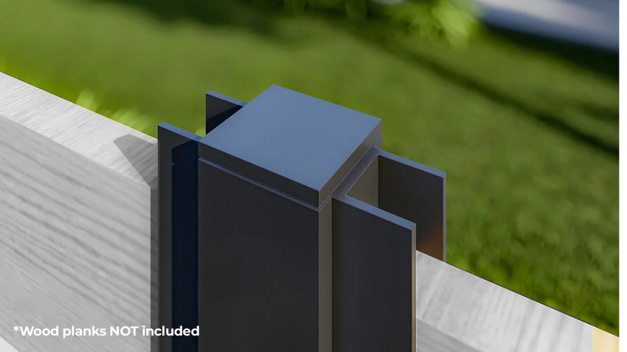

My neighbor and I are replacing a shared fence between our properties. We've agreed on a double-sided horizontal picket fence that simply has a 6' picket slide down C-Channels attached to square tubing. Similar to the QuikSlip Fence kits, but taller and cheaper.
We're both DIYers who want to save money, so we've priced out parts from a local metal supplier at $600 (raw steel square tubing and c-channel), vs $1300 (complete) for the QuikSlip, and $1800 (complete) from a local fence installer/builder/supplier.
Some methods of building the posts include rivets, bolts, self-tapping screws, and welding.
Personally, I like the welded idea because it gives me excuse to get a small welder and practise. I'd probably also weld little plates on the top of the posts to serve as caps.
...but I also know that what sounds easy to someone who doesn't weld is probably more complicated than I imagine.
Any tips? Which welder from Harbor Freight?

Is the Quickslip made of extruded aluminum?
Problem I see with steel is it's going to need a good finish after you weld it, or it's going to rust like crazy.

I love the idea of having a project worth learning to weld and giving practice time.
I wouldn't do it on a fence.   It will be exposed to the elements, and buried in the dirt. Unless you have access to powder coating equipment or something equally capable of highly durable finishes, you won't be able to adequately protect it. It will rust fast.
The store bought stuff will have a durable finish on it (and maybe a warranty)

You are trying to sell the idea by comparing prices, but you are not comparing apples to apples.  The Quickslip is extruded aluminum that is powder coated.  Your welded system won't be aluminum nor powder coated. And your $700 savings will rapidly be depleted buying welding equipment and consumables.
If you wanna build it, by all means build it. But don't compare it to the Quickslip and say it's about saving money.

Why weld C to square? Personally if you want to weld I would use the square but get 1.75in square tube and weld a 4" flat on either side.
It will look cleaner and not show off your weld learning curve.
Prime with weldable primer, paint it with Rustoleum, plug the top with plastic plugs from McMaster Carr.
