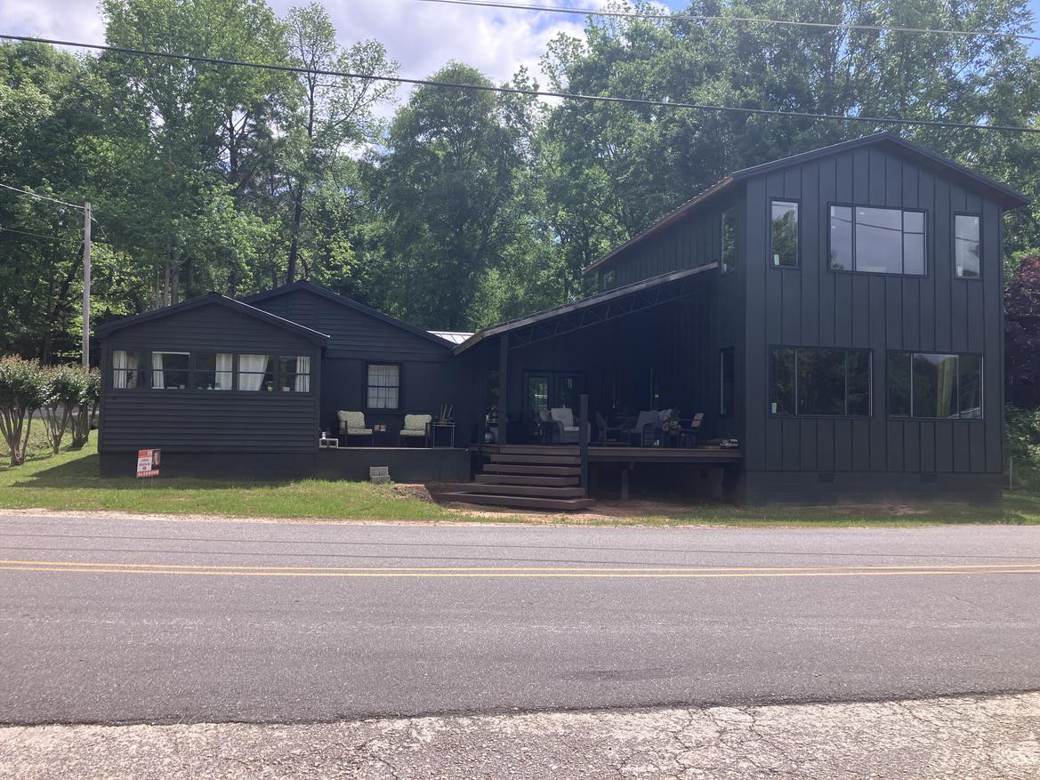

I just put Hardie on my own 2 story house. By myself. On weekends. Using 4x10 sheets of the stuff (heavy as crap).  It took a long time, but the house looks fantastic.
My house is about half the size of yours and I didn't have to do the windows and had no demo, but I have less than $10K in it (no labor).  I would have guessed $30-50K with the MD tax.  Looks like I'm pretty out of touch with reality- don't think I can help much.

I'm not mad about the final product! 😊
