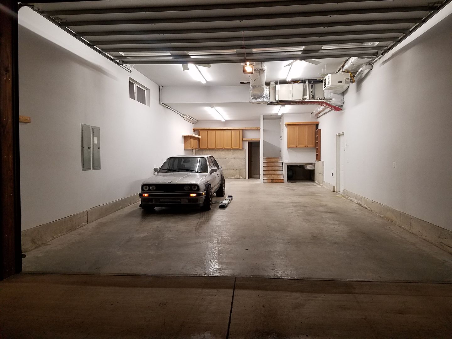

I've been thinking about adding an overhead hoist in my garage. I can't say I would use it often but I could use one right now to pull the engine out of a boat and I'm sure I could come up with some other uses for it conjoined with my lift. I literally haven't done any research yet because the wealth of knowledge here proves greater than google sometimes.
Does anyone have one? Did you install it yourself? Have you helped your buddy ziptie one to the door header and know what you're doing? Did you stay at a Holiday Inn express last night?
For information on the garage; it feels like RV height. 16 foot ceiling maybe? I'll have to recheck, I forget. The garage is the ground floor and there are two stories above it. The living room, guest room, bathroom, kitchen, laundry room are all over the garage so I don't have a lot of access to between floor joist. It's also finished. Sheet rocked/painted with the A/C/furnace ceiling mounted on one side and a slight step down in the ceiling.
Is this possible? Dumb? Genius? A waste of time?
I had a Harbor Freight chainfall on a trolley cantilevered out of my old garage loft. I used a 4" super I-beam (thick flange and webbing, wider flanges. Super Handy. I hauled a slate pool table up into that loft with it. Tons of wood screws and u shaped hangers attached it to the joists.

Based on the picture and your stated needs, a gantry set up would probably be the easiest solution.  With wheels it can be moved out of the way and positioned where you need it for a specific job.

Gantry is good and you can pick them up used pretty inexpensively.  If you want something very versatile you essentially build a square inside your shop.  Four columns, two I-Beams running the length, then another beam running crossways on separate trolleys.  That way you get all points covered and you have essentially infinite width and are not stucking working around a gantry.
I wouldnt anchor anything to the ceiling, thats asking for trouble.  Anchor to the floor, do your beam calcs, and dont forget the weight of the steel, gantry, and chain hoist in your beam calculations.  Common sense and safety says make the critical connections bolted unless you are a real deal certified weldor, oversize the fasteners and you will be just fine.  3/4" grade 8 bolts are remarkably strong.
For drilling through beams, a mag drill with a slugger bit is worth its weight in gold and they damn near better be made of gold for what they cost.
This is one of those "good isnt cheap, and cheap isnt good" sort of situations.

You're probably right. Easiest yes, but the least ideal.
AWSX1686 (Forum Supporter) said:
So there's this: https://www.harborfreight.com/1-ton-telescoping-gantry-crane-41188.html
I haven't used one myself, but it seems like it would be alright, and mobile. Takes up a lot of space though.
I saw that and it looks great but not wide enough for my first use. IIRC, the boat trailer was something like 95" wide.
I was also trying to avoid having a rollaround unit. I had hoped I could run across the bottom of the joist and be okay. There really isn't a good spot to have legs come down. There is a window in the way on one side and shelving/reznor heater/furnace on the other. (At least in the area where an engine would be on the lift.)
