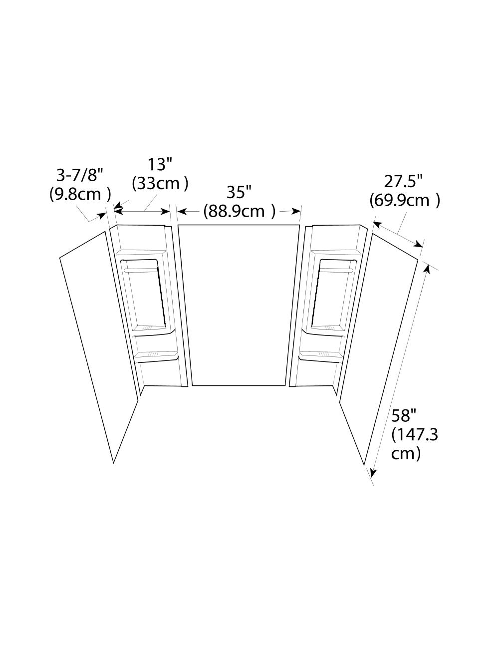

I did a home depot surround kit like this one
I think it was on sale for $153 but its $179 now.  That plus two tubes of loctite and it was super simple.  Mine had a wee bit of trouble in one corner because the wall wasn't plumb.  The corner piece wanted to buckle away from the adhesive so I had to put one pin nail in it which I later took out and filled with silicone.  Can't see it unless you look really hard.

In reply to Curtis :
We looked at those but I couldn’t seem to get an answer on how easy it would be to cut for the window. And yeah, I’d definitely want smooth vs textured for cleaning purposes.

I altered the height of mine because the wall at the end of the tub didn't go quite the whole way to the ceiling.  It had a little "shelf" on top of the wall.
Cutting is easy.  It's not fiberglass, its just acrylic or ABS or something.  My first cut I used a jig saw, but the flexible material liked to bounce a lot.  Subsequent cuts I used a straightedge and scored it several times with a utility knife and snapped off what I didn't need.
In these directions for that enclosure it says to use a utility knife or a pair of scissors, but I would also imagine some tin snips would work well.
