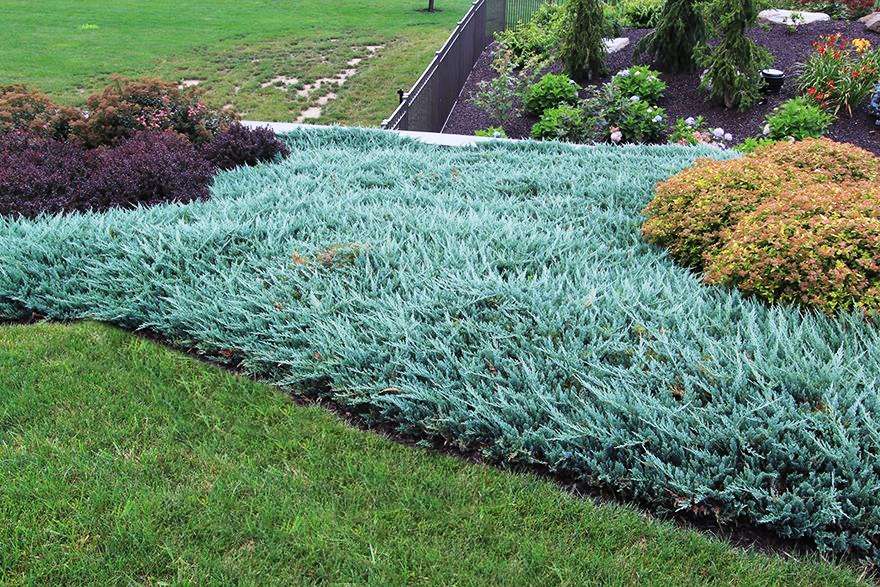

Does it need to be actual grass?
If not, I suggest planting a regular pattern of rug juniper across the area.  It takes a little while to get established, but it does take off and fill into a solid ground cover.  It really stabilizes the soils, and doesn't look bad at all.

And I still say dot juniper all over the area in a staggered grid about 4 feet on center.  Within a year or two it will fill in and never be a problem again.
