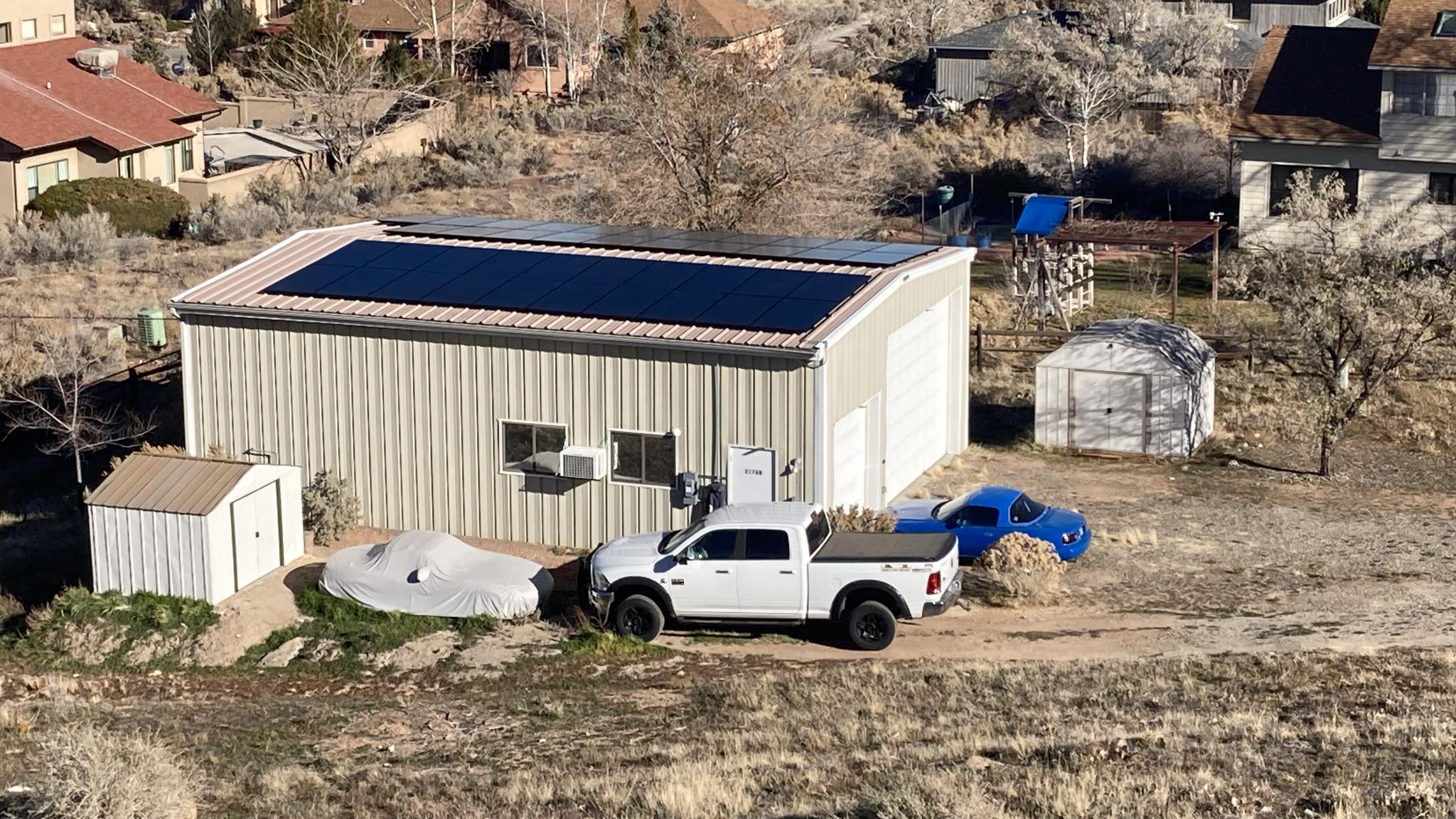

We installed a 16.4 kW system last winter. It's sized to produce 110% of our annual power needs, and we're using the grid as a backup battery - we get a 1 for 1 credit on surplus power. We're up about 250 kWh over the past month, our big usage season is midsummer.
Cost was 2/3 panels, 1/6 installation, 1/6 associated hardware (new panel, racking, wiring). The warranty is 25 years on the panels and inverters - newer systems like ours have an inverter for each panel, so it's more modular than having a big inverter for the whole (or a portion of) the array. I'm still setting up monitoring for individual panels so I can check the health of it all, but I've seen over 80% efficiency already. It's installed on the roof of my shop which is pretty much an ideal location, the only problem is a nearby cliff that provides early shade in the winter. By this time of year, the angle of the sun is low enough by the time the shadow hits that it doesn't really affect output.
It's worth noting that there have been remarkable improvements in lifespan, efficiency and cost of the arrays, so it's worth revisiting the pricing occasionally. It didn't make sense a few years ago for us, it does now.
The secret  to making it work is the financing and the federal tax credit of 26%. We talked to a few companies and they all came up with similar specs in their quotes, the one we went with was slightly more expensive but it was offset by some financing with ridiculously low rates - someone's getting a subsidy from somewhere. Yeah, we'll be paying for it for a while but since we're already saving money, that's fine. It's highly unlikely the cost of delivered power ($0.099 kWh plus all the surcharges, I think the effective rate is $0.13 or so) will go down, we're expecting time of use charges in the next few years which will only tilt the finances in our favor. What we've done is lock in the cost of our power for the next quarter century.
Almost every house in our neighborhood sports panels now. The ridgeline on the shop points due north, by the way, so half of the array is biased towards the morning and the rest for the afternoon.
