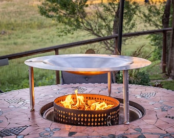

My company has made a few, and I'd like to build or buy (preferably build) one for my yard. Problem is, most that I've experienced are great for ambience, but 90 percent of the heat goes straight up and doesn't help the  people gathered around.
I'm interested in peoples experiences. I'm also wondering if one were to make an umbrella-type reflector that mounted over the pit, if that would help?

If doing one on the cheap, I'd go for a thick elevated steel pit.  You want something that will radiate the heat outward really well, and you want to elevate it up where the amount of that radiation you can absorb is maximized.  Obviously there is a tradeoff there for visuals & usability, but ideally you'd want it to be about the height of your stomach when sitting in your chair.
In theory brick radiates heat well, but in practice I guess the bricks are usually too thick.  You can often rest your shoes on the outside of them, so that tells me they aren't getting that hot.  A steel firepit will glow.
