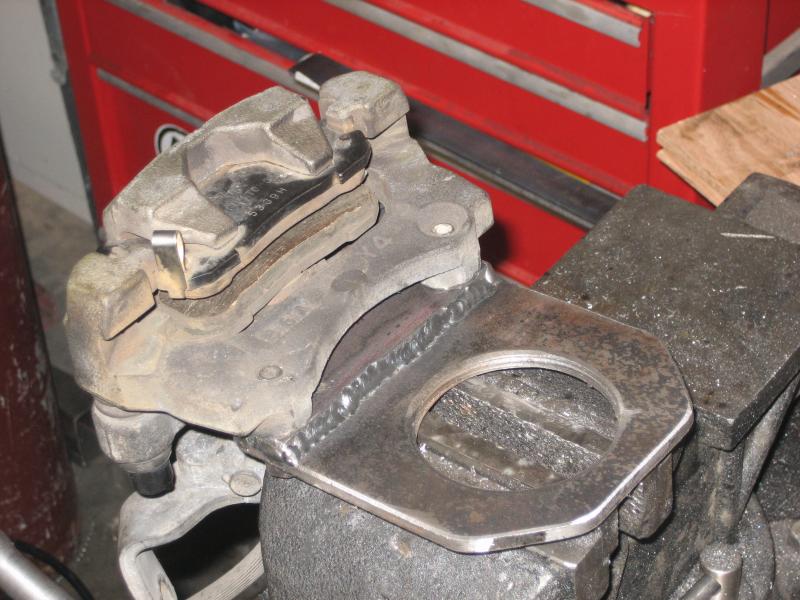

11/29/12 9:42 a.m.
First question is - what size piston do you need in those calipers?
It's easy to fit Miata calipers. Here's the bracket I used on the MG, minus two holes that were used to bolt the caliper on. I just slid this over the axle tube and welded it on.
