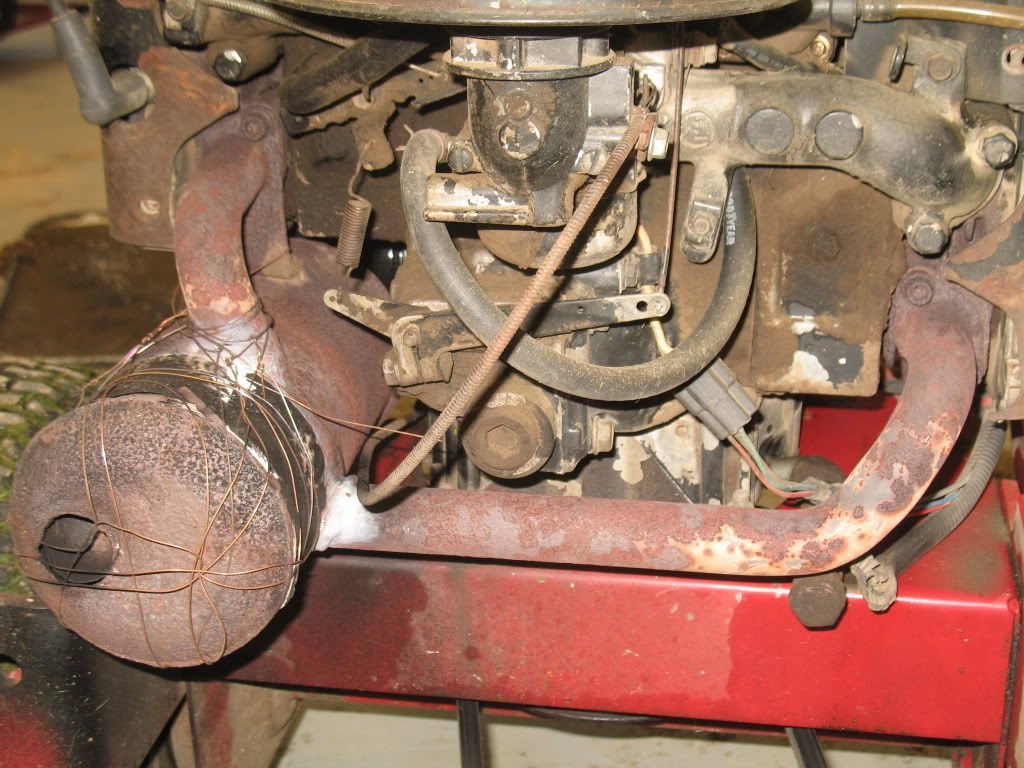

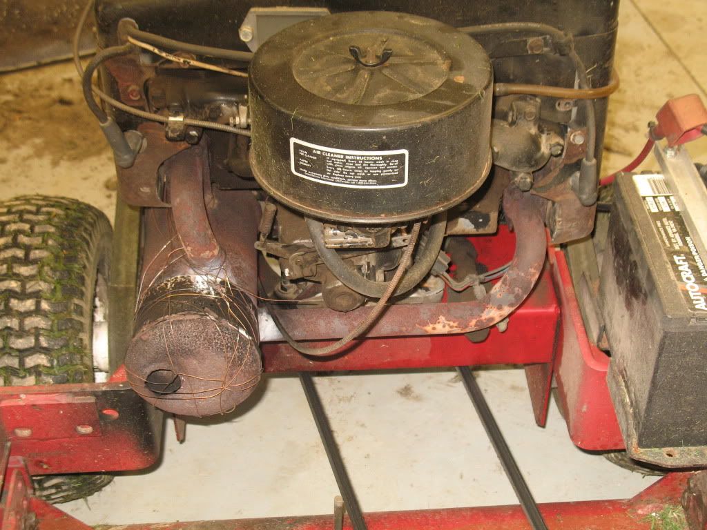

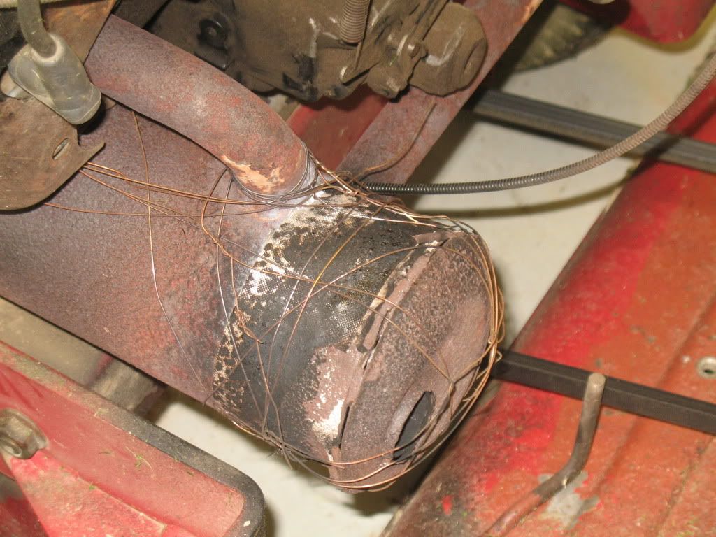

My mower muffler has gone bad and the replacement is $280. So I'm looking for a low cost solution. What happened is that the front of the muffler came off. For a while I was able to crimp it back on, but now it's rusted to the point where that doesn't work anymore. The body of the muffler isn't rusted through, but the metal is pretty thin and corroded, so welding to it isn't an option. The muffler is 4" diameter and the pipes are 1-1/8" OD. I also thought about adding some pipe to the existing pipes and use two small mufflers, but many of those install with pipe threads, and I'm also having a hard time finding 1-1/8" exhaust pipe and adapters. I'd rather not remove the entire exhaust, because it's held onto the engine with socket head capscrews and the hexes are stripped. Please excuse the grime and the half baked repair. My son was in the middle of cutting and had to do something. Any trick ideas come to mind?

Okay guys. First, I can't weld on it, as the metal is too corroded and thin. The mower is a Toro 52" ProLine 2000, the engine is a 16hp 2 cylinder Kohler,and yes, the OEM muffler is $280. I already wear ear plugs, as I have 50% hearing loss in both ears. My kids often cut the lawn, which takes about 3 hours, and the mower is WAY too loud without the muffler and the engine doesn't run well without it either. I don't want them to end up like me. I liked the idea of cutting the pipes off at the flanges and welding on the threaded pipe, but there's no access to weld at the flanges. I already tried JB Weld and it only held fo r a short time. I think the metal is just too corroded. My original idea was to cut the muffler off, get new pipes, clamps and mufflers and call it a day, but like I said, I can't find the pipe, the clamps or the 90 bend I would need for one of them, so for you guys that suggested that, an online source for these parts would be appreciated. I've been looking for quite a long time and haven't found what I need.

Already tried that. If you look close, you can see remnants of the tape in the second pic. It actually worked better than the other band-aid fixes, but still didn't last long enough.

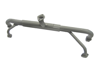

If they are too weak to weld, then any attempted repair is likely to be futile, or only postpone the inevitable. I can't really get an accurate sense of the size, but you might be able to cut off and adapt the flanges from the heat riser tubes on an air-cooled VW intake manifold. Someone here probably has one collecting dust.
