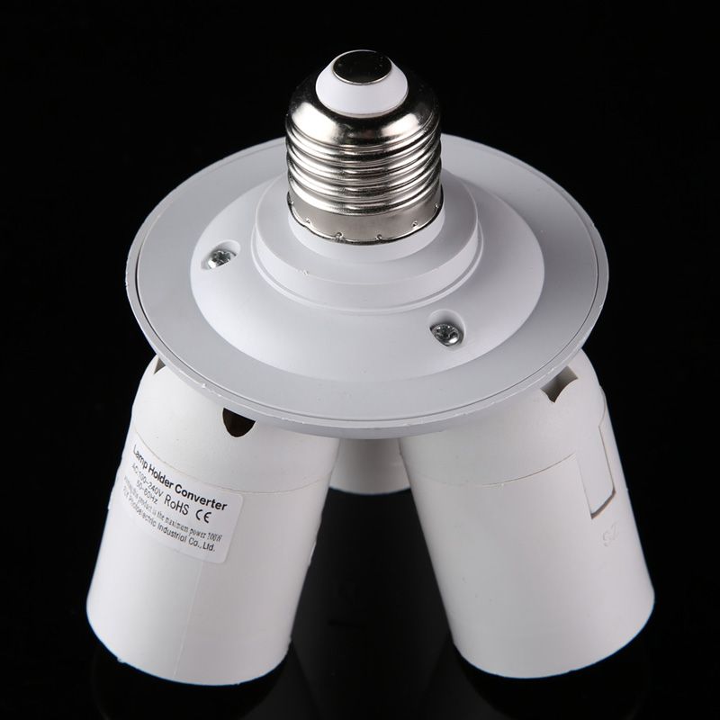

and what's the spacing like? You're probably going to want to pay attention to the throw angle of the light.
what about using something like this to spread the light around a bit more? looks like you can find them in the $5-10 range after some searching.

Yes sir! You read my mind!
