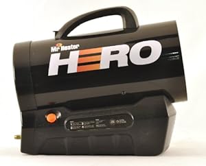

I've got the cordless Mr. Heater Hero forced air propane heater, it's alright, fan will run about 8 hours on a full charge, and a 20# gas grill sized propane cylinder will last about twice as long as the fan. It does increase the CO2/dead risk. I usually had it running for 45min to an hour and off for 30min or so in our uninsulated 1 car 14' ceiling garage during central OH winters.
I accidentally had some brake cleaner vapor/overspray get sucked through the intake of the heater once, it was a really bad experience. Five minutes of coughing, couldn't catch my breath, tunnel vision you get just before you pass out. I stayed conscious but it made me extra cautious about anything I did around the heater, when and where I used it.
