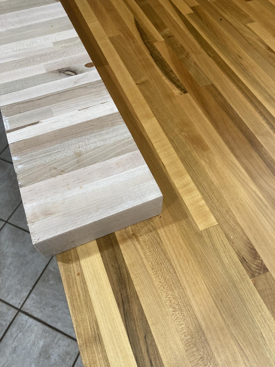

I used satin waterlox on my countertops and like the way it looks. It will give a slight amber tint but looks better than a shiny coating.
Maple butcher block before and after.

I got these from Floor & Decor. They have only been in for 6 months or so but I'm happy with how the coating holds up and repels water and the counters look great for how little they cost.

I did (I think) 2 coats of the tung oil sealer and 2-3 coats of the satin H20lox because I was doing it inside and wanted less fumes.
