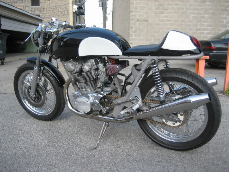

Curmudgeon wrote: Yep, the big case has to come off now. Do yourself a favor and get one of those hammer driven impact drivers before you go any further (I'm assuming you don't have one now). Those 1970's Honda screws are made of something very similar to cheddar cheese and will round out if you look at them crosseyed. That's why I say if I meet that guy Phillips he will die a horrible lingering painful death, I don't care if they were designed as a torque limiting device. Clutch after case removal: Not a 450, but the design is similar.
Those impact drivers are the old motorcycle owners best friend.
The screws aren't Phillips heads, they are a JAP #3 IIRC.

In reply to 4eyes:
I bought one just like the one in the picture and it is as useful as tits on a bull.
