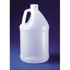

I've not tried this yet, but is there an oil can or spray bottle that does not dissolve in acetone? I'd like to keep this on the shelf.

Any type made with HDPE ...check the bottom of the bottle, the plastic type should be stamped into the plastic.

HDPE bottles are easy to spot, it's that translucent white plastic (opaque if it's thick enough):
