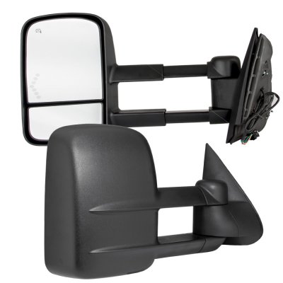

Keith Tanner said:
Not a specific recommendation, sorry. I can say based on my towing experience with a 28' and the factory Dodge mirrors in tow mode that I am actually pretty happy with visibility overall. The only blind spot is directly behind the trailer, which is probably the area that is of least concern to me overall. My mirrors have a convex section that does an excellent job of removing typical blind spots.
My big trailer is 8.5' wide and the blind spot directly behind the trailer is worse than I'd like no matter how far I extend the towing mirrors.  I often travel in a caravan and if someone is following me, I'm wondering if they're still behind me, so that's one of my motivations for a camera. I'm using copies of the factory towing mirrors that look like this, with the bottom parts convex:
I see vehicles on the sides/blind spots very well with these. As I think about it, codrus' point about maneuvering vs driving is probably a big motivation for me. Except for directly behind the trailer, I'm ok when driving. But backing into a tight space means having an assistant or jumping out and looking more than I'd like. I think cameras could help there.
Thanks everyone for all the replies so far.
