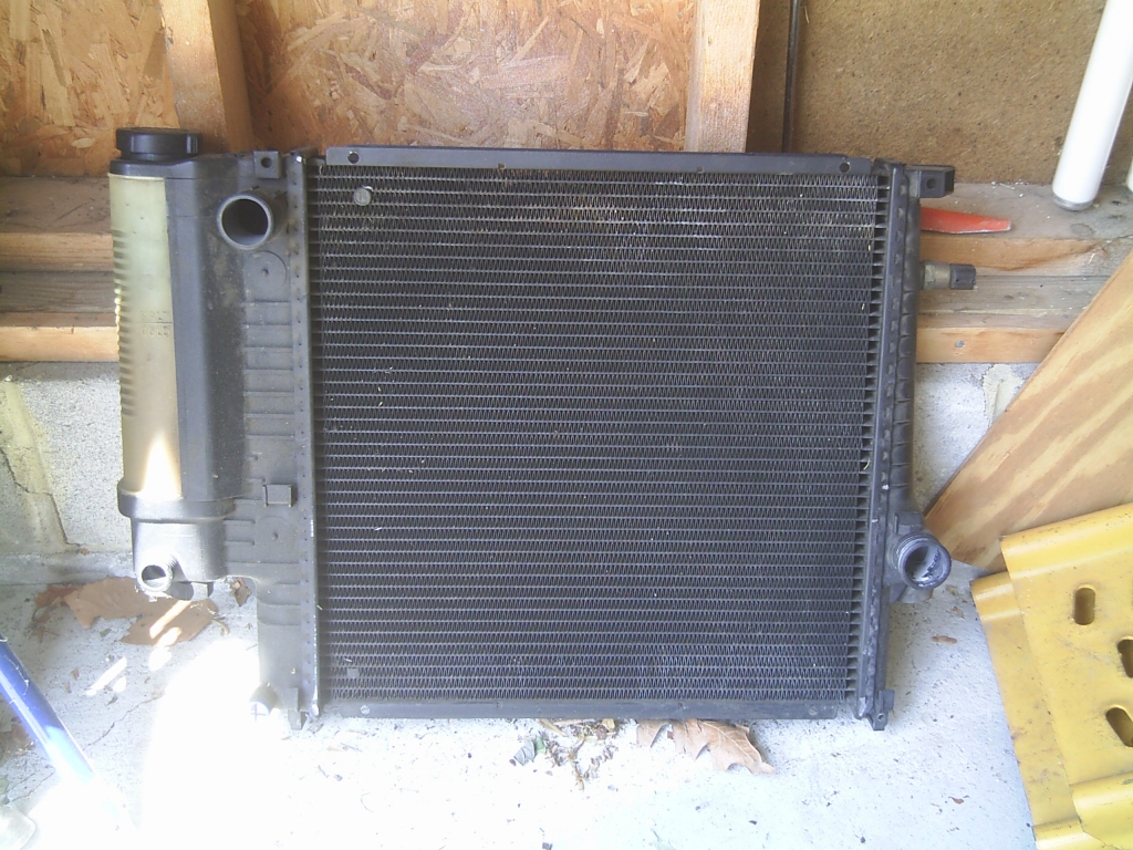

The m42 powered cars had a radiator with a built in overflow tank. They are pretty cool.
