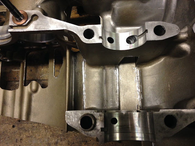

Haven't gotten to the wheels yet, but finished tearing the old engine apart. I deburred the new bottom end cases before giving them a thorough cleaning in the solvent tank.
Kinda hard to see, but there were some nasty burr-filled casting ridges. Before:
After:
I also measured for new crankshaft main bearings and ordered those along with a bunch of gaskets, o-rings, circlips, and replacement hardware. Oh yeah, piston rings, too. I probably missed something small, but I am hoping I am not to far away from reassembly.

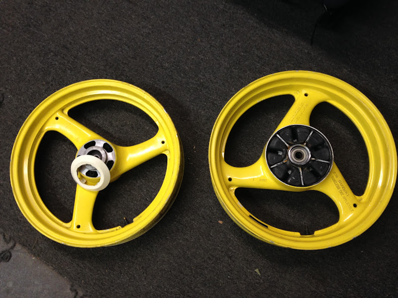

I also got these stripped of external parts and tires to deal with the awful color somehow. I flaked the paint off the plastic trim ring on the front wheel by hand! I didn't see any signs of primer or prep beyond cleaning...hmmm...you mean it takes work to get good results with paint? LOL
In the meantime I will get these two-year-old, 50-miles-from-new tires scuffed in on my Supermoto!
