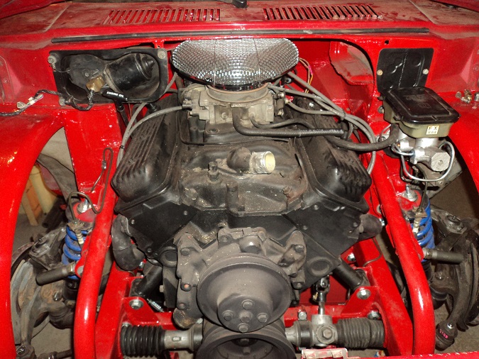

Small block Chevy in my '87. ~Really~ hoping to get back at this this winter....

I know.... I've been busting my butt trying to get the shop finished. The Firefly needs to move in before the snow flies, but I'm still final mudding the ceiling and walls....
