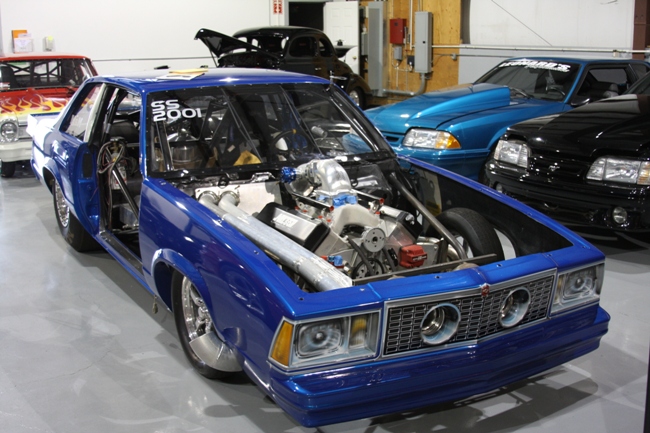

5/15/14 7:42 a.m.
914Driver wrote: Love that body style.....
Me too. There is a poop brown one in the southeast that streetraces. Fast car that always takes the money.
Obligatory hotlink:
