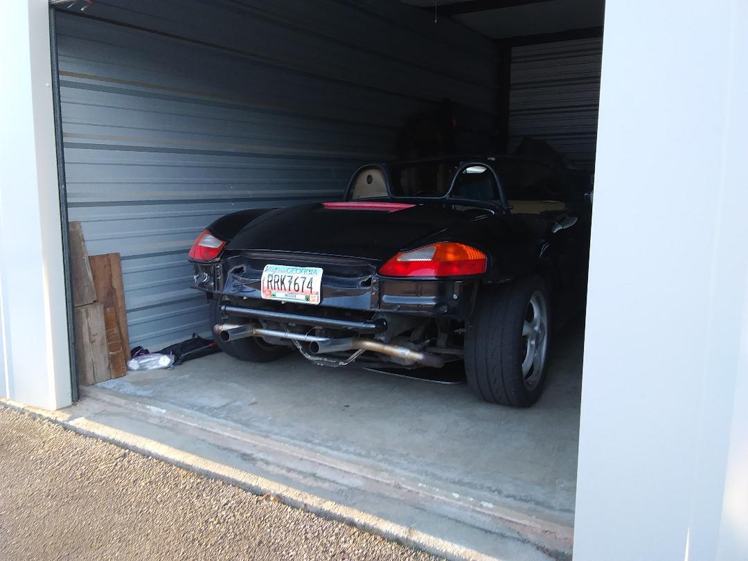

Really enjoying Jon's exhaust pipes. They actually sort of make me slow down a little on the road. I checked with my mechanic friend re. the loudness. He said it was fine for this county. Not very confident about driving anywhere else, though.
One of the big differences with the Boxster vs. other lighter cars is it yawns at 100 mph so it's hard to keep speeds down, at least for me. Smaller diameter tires will also slow me down a little as a side benefit.
Tires. I'll probably start out with Toyo R1R 245/35/17 squared. 1.2" smaller diameter than stock plus at least a few pounds lighter. Not my first choice but a good start until the suspension can provide -3 camber or more. Unless I get coilovers first, then it will be RA1s or A052s.

Talked to Pedro today and he said the muffler support on the transaxle does not provide suspension support as someone had stated on a Boxster forum. Off it comes and will support pipes via the bottom of the trunk, I think. If research continues to support Pedro's under brace for the rear suspension I will order soon. Opinions on under brace? You can see all of the black spray paint someone used underneath everywhere. %$!*&!
Ignore, just rambling here;
So far have removed about 60 lbs. from behind rear axle and there's still some more to pull. I haven't had a full day off in about five weeks but will see some daylight in a week or so and will start pulling more weight off. Currently at -325 lbs., which puts it at 2497 lbs. and should remove another 50+ lbs. this coming month. Will pull remaining carpet, door guts, stereo, dash stuff, rear spoiler. Need to find an old cheap racing seat.  That would delete another 20 lbs. The heavier wheels up front will negate the lighter tires but the rears should save about 6lbs. And the suspension should save around 15 lbs. but just guessing. The windshield, maybe 40 lbs.? That'll be 150+- lbs.. That's 2350 lbs. total. Power steering to manual lbs.?  Maybe -50 lbs. in body etc. parts but add 100 lbs. in body parts and restructuring. I'm still shooting for 2350 in the end. That's about a total of -475 lbs.. That's 16% weight removal. With an extra optimistic +10 whp, that puts lb./whp at 13/1. stock is 16.5/1.  About a 20% improvement not counting freed up hp in rotational stuff. And a lot of aero resistance removed. Stock weight equivalent to 205+ whp. Apples and oranges but there it is.
Also ordering a Xenon headlight kit from Pedro next week which will be brighter and cooler. I DO NOT wish to melt my nice clear headlights Jon just sent  me!

Had a great day. First day off (almost) in five weeks. Sunny, sixties, four hours pulling 32 lbs. off.  Total weight 2,465 lbs.. Slow going but actually pulled more weight than estimated so well worth the time. The best part in the process of pulling weight is knowing you don't have to put the parts back!
Tail is off, 7 1/2 lbs. Will replace with lighter plastic (Jon, you have anything available?) , but I wanted to be able to see where aero will be exiting from trunk.
Jon, have you ever considered fabbing ten or twenty of your exhaust pipes, in stainless? A buyer could stick a couple of those inserts in the tails if they wanted it a little quieter. They are so smooth, no hiccups even during hard downshifts or letting off the pedal hard at high rpms.

For aero and a better cosmetic look on the back how about fabbing with some aluminum similar to the roof I put on my Challenge Boxster? I had a hood from an Audi A8, but if you have a local scrap yard, you might get some good light weight sheet cheap.
I want another one of those exhausts for MYSELF. When I made that one I was fortunate to have the right piece of scrap laying around. I plan to get a tube bender this year and fabbing some more of those would be a good way to learn how to work with it.
Lot of broken spec Boxster exhausts suggest this is a bad idea, and you'd be better served with some sort of rigid mounting to the back of the transaxle like factory; so that the exhaust can move with the rest of the drivetrain.

How about cutting down that rear transmission bracket to the minimum needed to bolt on and brace the exhaust?
