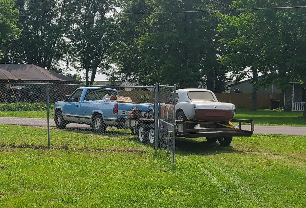

Another exciting parts finding trip. I found a guy with a parts horde near my parents.
Mom n Dad headed over to see what they could find.
They came home with a nice pair of clean doors, complete chrome set and too many other parts to mention.

Nice haul!
