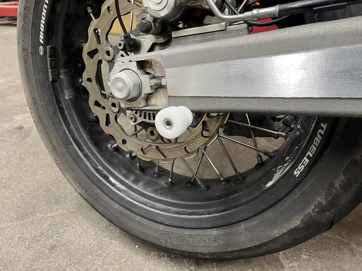

I've put a thousand miles on the bike since replacing the stator, so I was due for an oil sample to send in to Bkackstone for analysis to ensure that the elevated lead and copper levels at the last oil change were all due to the burned stator. I figured I would just do an oil and filter change while I was at it.
Now that I've got the fuel system working well, it was time to tackle one of the last remaining issues with this bike: with the supermoto wheels mounted, once above about 45mph continuously for 1-2 minutes, the ABS light comes on and the ABS shuts off. sad
I've got lots of experience riding bikes without ABS, so I have kept riding. Some around town trips I never cross the speed/duration threshold and it stays active. Since I bought a bike with ABS, I want to use that ABS I paid for! laugh
Long story short, the size disparity between wheelsets (supermoto slightly smaller in the front, enduro smaller in the rear) was enough to trigger an error. I spent a looong time troubleshooting before coming to this conclusion, playing with tire sizes, tire pressures, ABS tone rings, ABS sensor spacing, speedometer calibration settings, without any luck.
I finally found a chap on the ADV rider forums named Ian Chappell who makes custom tone rings and ordered a set. I've had them on the shelf for a while, and finally installed them today.
Rear side-by-side. The stock one is black.
Got lazy and figured I might not need to bother with trying to snake the rear wheel all the way out/remove the rear caliper/etc. The new rear ring is going on in this photo.
Time to change out the front ring.
Front Ian Chappell Engineering ring installed.

Got a couple more small things done on the Husky. I topped off the battery with the trickle charger.
Here's the worn slider.
I replaced it with new.
A little slide protection goes a long way towards minimizing damage and is cheap to replace. I'm planning to add bar end sliders before riding again.
