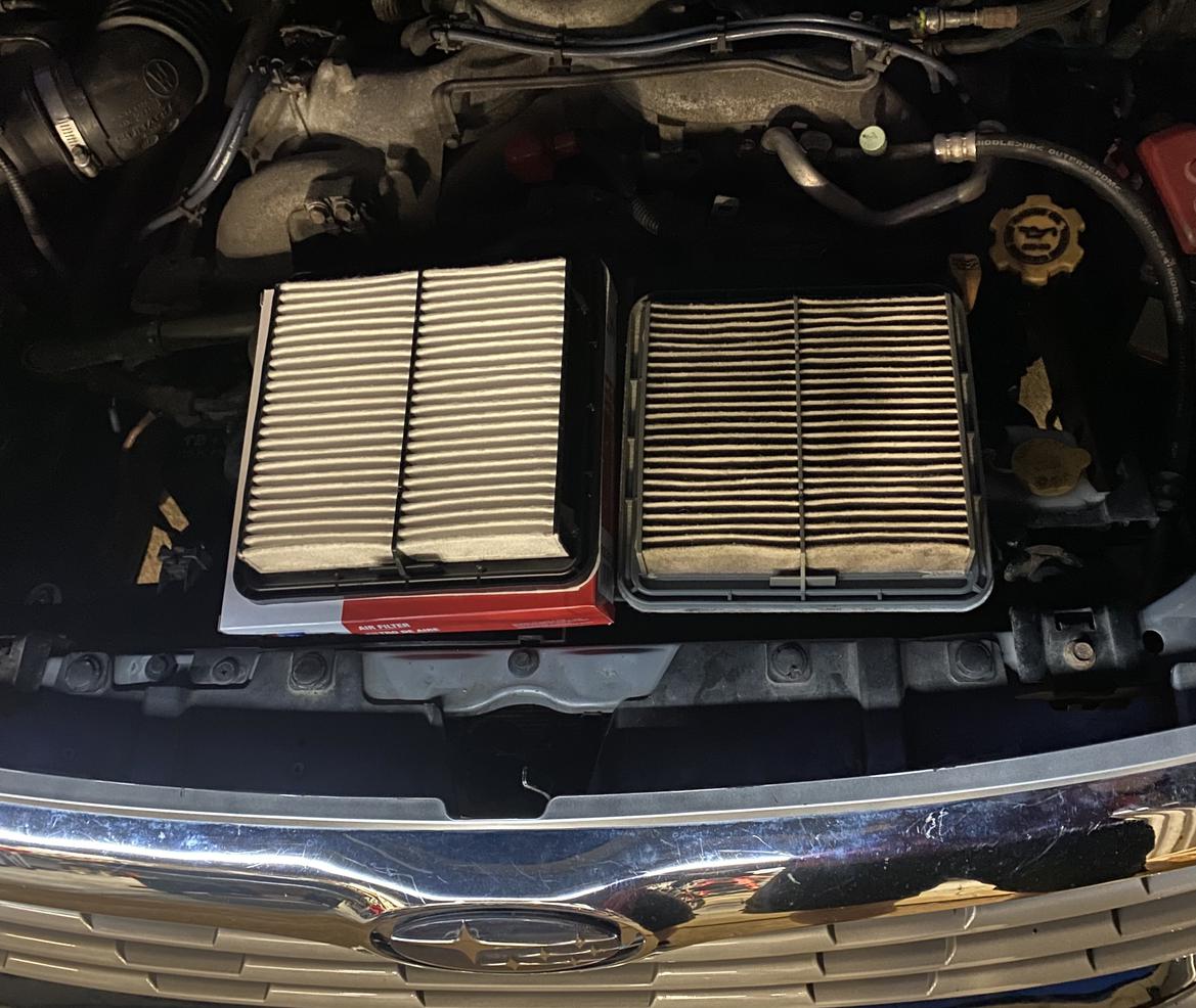

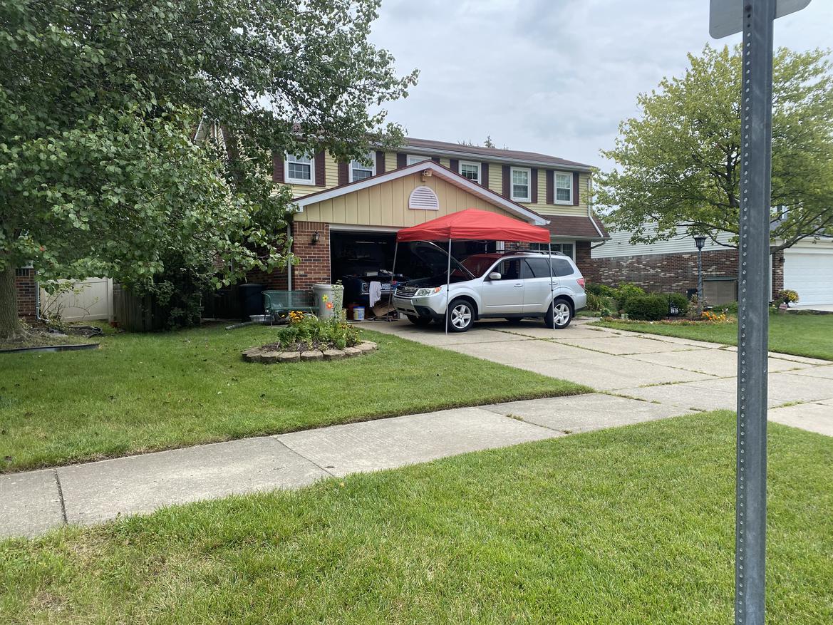

It was a busy weekend for me and the Forester. I dug into the timing belt job and found it looked fresh enough to roll the dice, so I decided to return the TB kit and spend that money on ignition parts. I put the front of the engine back together and moved on to cleaning the MAF sensor and replacing air filter:

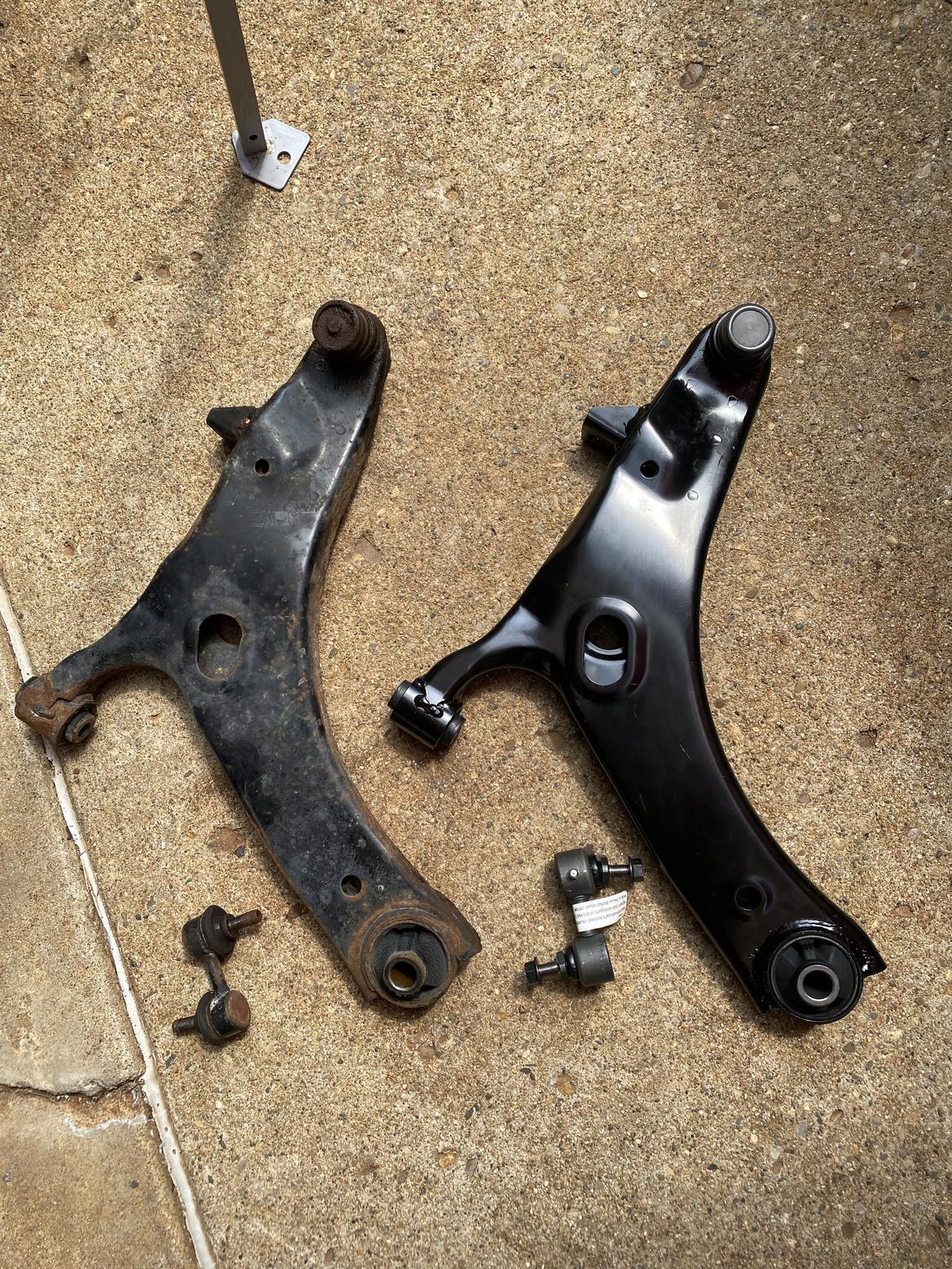

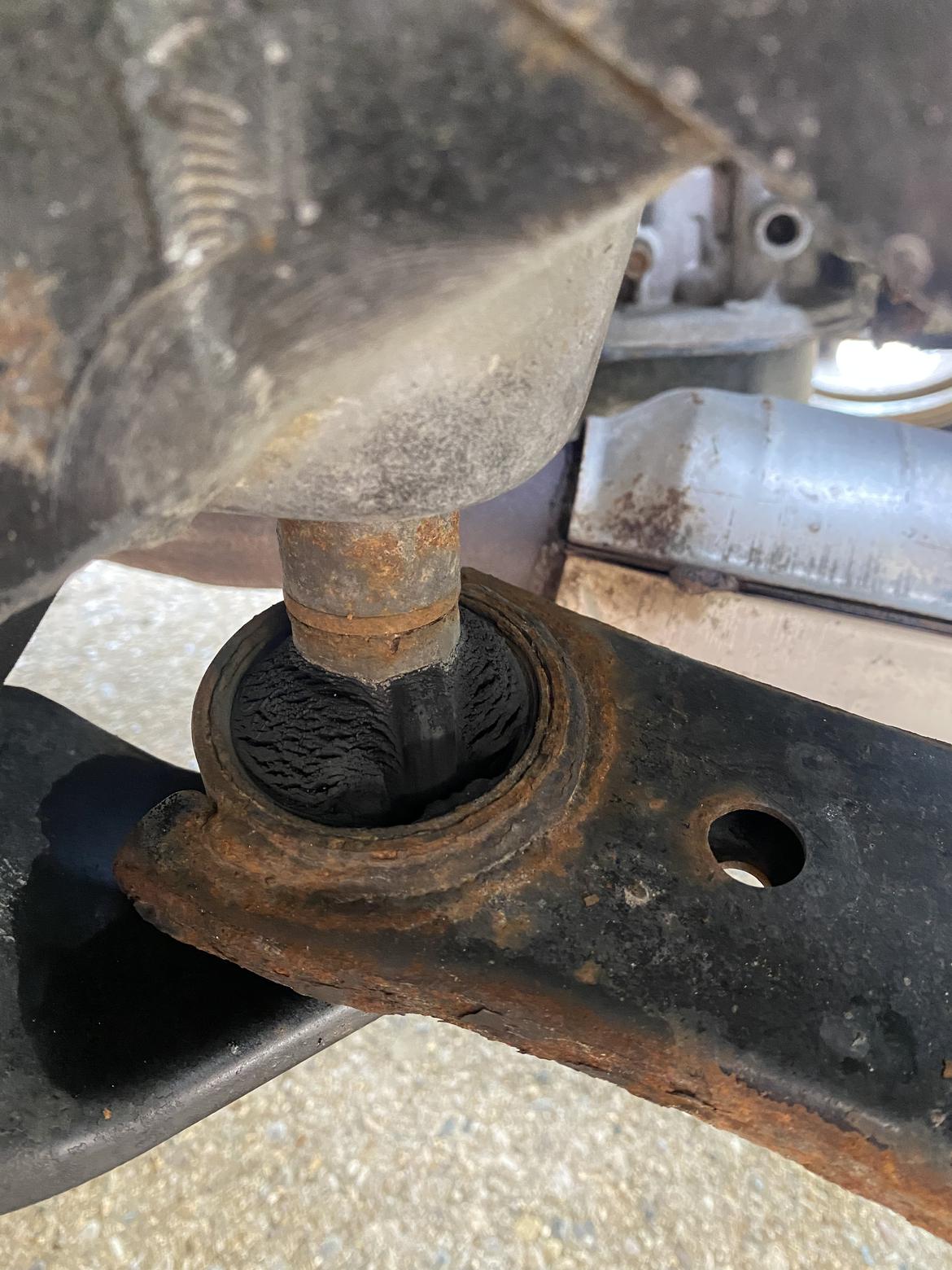

followed by R&R of front LCAs and end links. The front end is clunky any time we're *not* on the brakes, so my theory is that the rear bushings of the L arms are smoked. Theory confirmed:
The RF came apart better than I expected. Old and busted on left, new hotness on right:

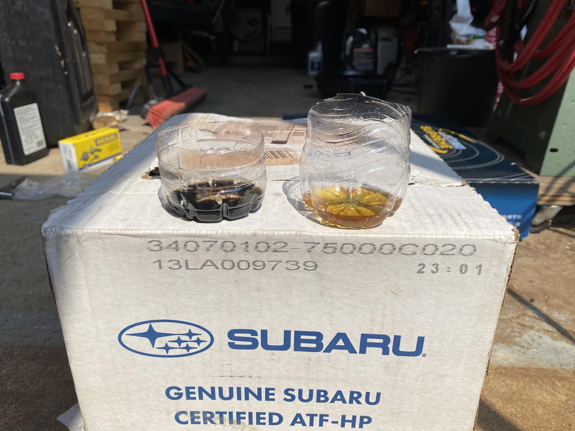

while the car was in a good position for it, I drained as much ATF as I could (measured almost exactly 4 qts) of what I suspect was the OE fill. Guess which is old and which is new:
So I refilled with fresh ATF and moved on to engine oil change. What I drained out was about 2-1/2 qts of the blackest, yet somehow not sludgy, oil I've ever seen.
And whoever installed the oil filter last time around, well, i hope his wife has the mailman's baby. Anyway, with both fluids refilled I went back to the suspension job. Google found me the the torque specs I needed:
so I buttoned up the RF and turned the car around so the LF would be in the shade. It got up to about 90F and 90%RH today, so shade was a big deal.

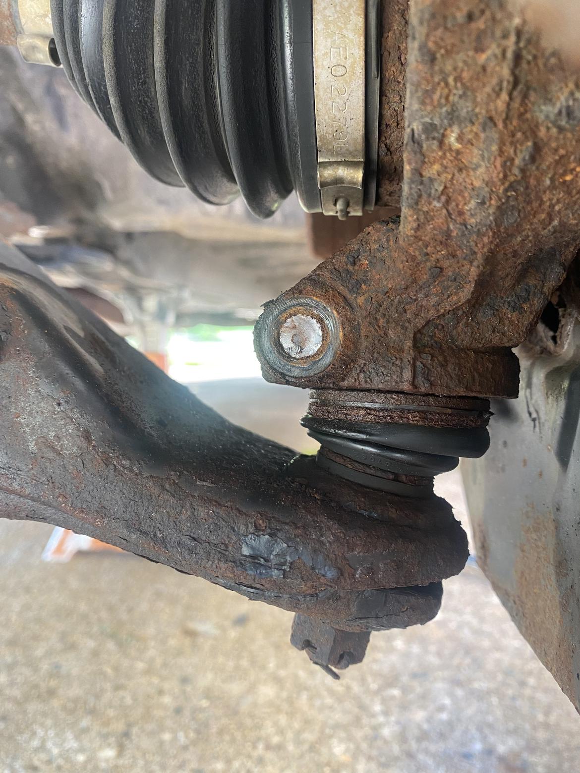

LF was coming apart nicely until I broke the pinch bolt for the LH LBJ. At that point I was hungry and tired so I put the LF corner back together and called it a day. Tomorrow after work I'll try to weld a nut to the broken bolt and work it out. Maybe the heat will be my friend.
I also looked more closely at the scrape guards under the gas tank, and the RH guard is definitely warped and stained from gas leak. I hope whatever is behind that shield is easy to fix and solves my P0457.

Haven't been to the yard yet, bought a new pinch bolt for $1.80 at Glassman since I was near Tel-12. Suburban has a new knuckle in the $150 ballpark, or I can pay $40 for a JY knuckle that almost certainly has a broken bolt in it, or I can berkeley around with the one I've got and maybe or maybe not succeed at getting the broken bolt out. Wife says "buy the new one. You've earned it."

You can drill the existing bolt out completely, then use a longer bolt with a nut on the other side rather than relying on threads in the knuckle.  Through some combination of luck and skill I've never personally broken one, but I have heard of folks though bolting them this way. Given appropriate grade fasteners and locktite or a nylock nut I can't see why it wouldn't work.
With these what I usually do is a ton of prep work before attempting removal. Take a thin file or hacksaw blade to the gap in the center of the "pinch" area to clean out rust, soak with penetrating oil for days. If it won't come out, I then partially drill out the bolt from the side w/o the head (leaving enough of the bolt so that the female threads in the knuckle aren't damaged) before attempting removal. I think the pre-drilling helps relieve some of the pressure on the threads, plus the heat from drilling probably helps too. There's usually no need to drill past about the halfway mark as all the threads are on the non-bolt-head side of the knuckle.
