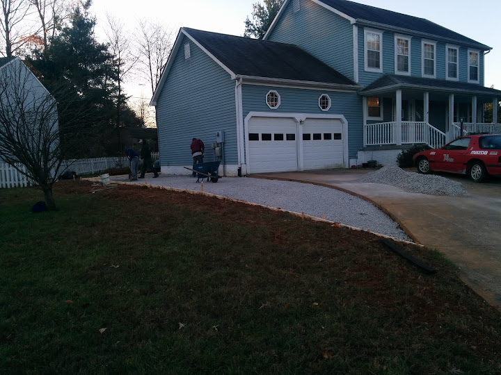

As detailed a bit in this thread we added a little more parking for the van/trailer.

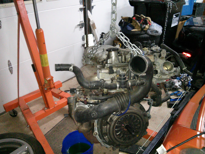

While somebody else was working on the driveway I need to do some work on something. I got tired of trying to get the Spicy transmission hooked back up from under the car so I decided it would be better to just pull the engine to mate it up. I had loaned out my engine hoist a while ago and my friend who had it was not really using it so I got it back from him.
Boom! Engine out. Snap! transmission connected Empty bay.
I think that was much easier to attach it that way. Now to get it back in and get everything hooked back up.

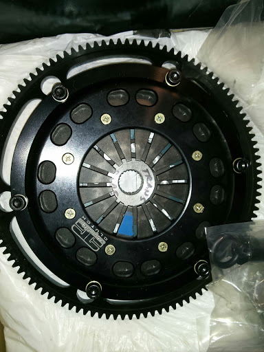

Back in Sept I bought a 949 SuperMiata Race Twin Clutch Flywheel from a user on here for the CSP car since I did not know what it had installed. The prior owner did not know and searching the owner before thats posts I could not tell either so I figured the 949 one would be a good option to put in since if I am pulling it open to check I might as well put something in and if there is currently something good in there it can go on the RallyX miata. It is pretty nice looking. Pulled the trans and found it had an ACT clutch and 9# INDIGO aluminum billet flywheel. Those will be some nice parts for the rallyx car. Trans was dirty as they always are. I feel much better putting this back in. Flywheel Installed. Clutch Installed. While it was up on the lift I cleaned out a few rocks from the front fenders. Yeah just a few. Had to go stock up on redline for the miata's.

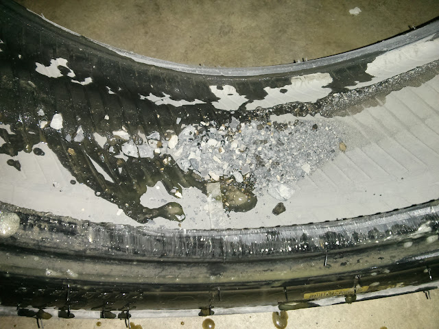

Old snow tires dismounted, Old rally tires dismounted. Anybody need some 15x6 5x114.3 ET45 steel wheels cheap? New snow tires all mounted up and ready for balancing.

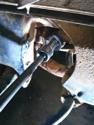

Got that inner tie rod end replaced.

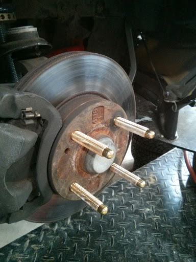

And just before the end of the month I got the new wheels I ordered back in Sept. The new 949 6UL 15x11 wheels for the CSP car. 14.3 lbs now I just need to cut a little more fender and get some spacers and longer wheel studs.

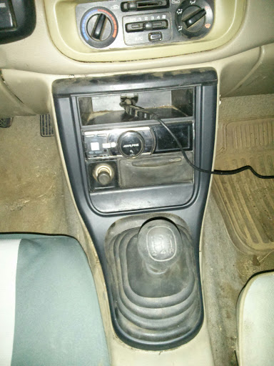

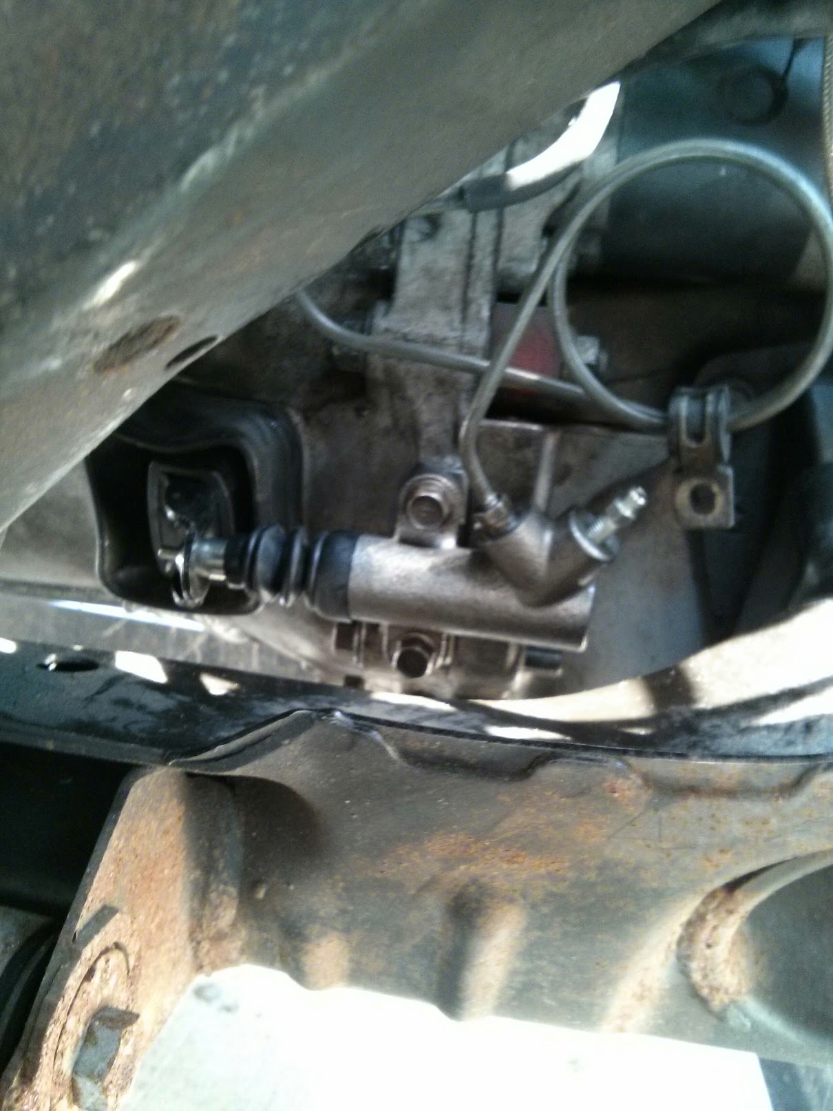

Ever since I got the impreza the shifter had been a bit floppy toward the 1-2 side but I had not taken the time to dig into it and figure out what the problem was. The radio surround was also broken and crappy looking with the radio falling out. Since I was fixing other small things I started working on those.
The shifter? There is spring that should have been on the transmission that was not there that pulls the shifter back to center from the 1-2 side.
Now installed. For the radio I pulled the whole center mess out and actually screwed everything into the cage. Yeah it will be harder to uninstall if I need to but I don't see needing to do that anytime soon.
Bought a new radio surround and it looks like a normal car somewhat inside now.

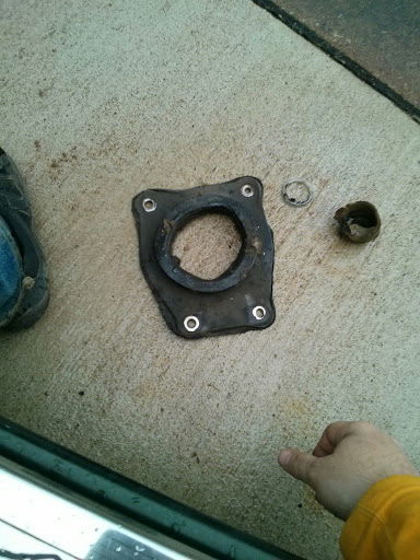

When I started to install the hardtop bracket kit last year I broke one of the bolts in the hard top. I did not have time to drill it out then so I tossed the regular latches back on figuring 2 bolts in that would be better than 1 in the brackets. Got it drilled out and new bracket installed.

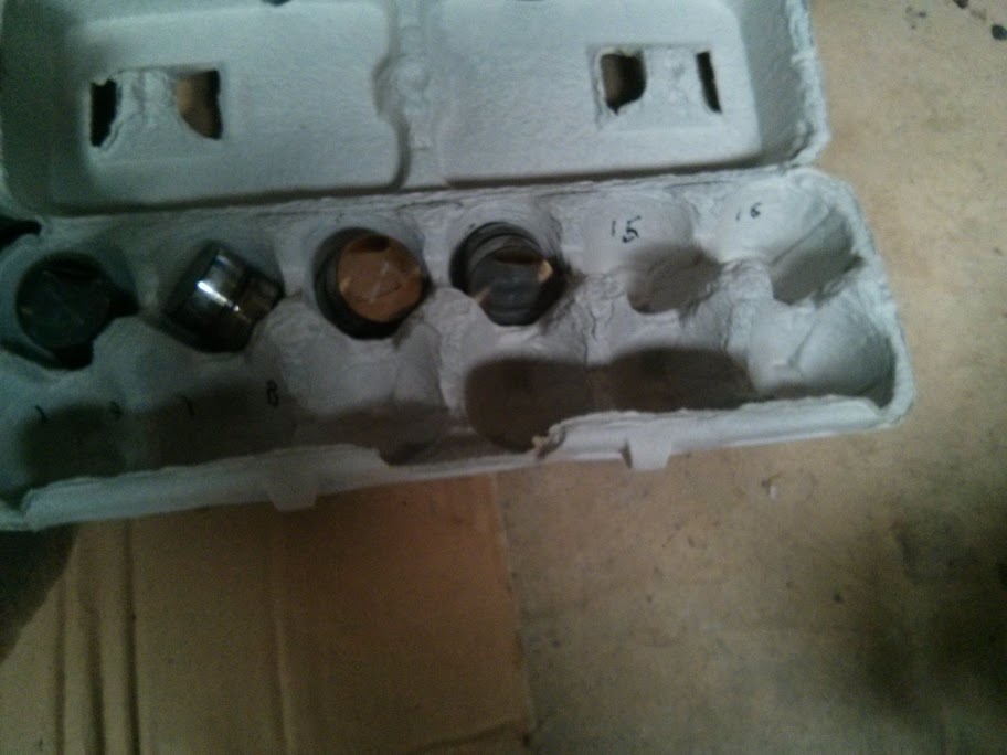

I needed some space for when I start working on taking apart the RX-7 engine so I needed to clear off my workbench in the basement. I tore apart this head a while ago and it has been sitting there just taking up room so I needed to put it back together and move it out of the way.
I kept all the parts in order (I think) Putting back together.

RallyX Miata Now that I made it thru the first rallyx event it is time to make changes to the car.
That pretty Indigo flywheel can now find a new home in the rallyx car.

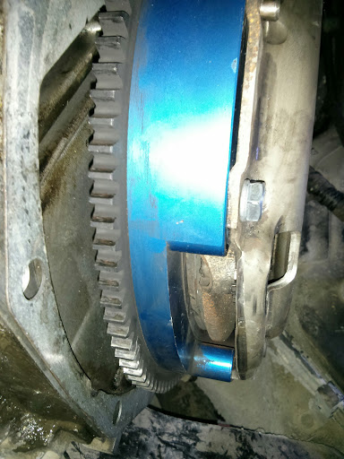

One typical miata clutch job later it was installed. Out with the old.
In with the new

Some nice long wheel studs.

RallyX RX-7.
I had a spare engine from a parts car I bought for the LSD so before I pull the motor on the rallyx RX-7 I wanted to tear down the spare motor and see how the hard parts are.
This should be big enough for the flywheel bolt.
I'm glad I cleaned that table off last month. It looks like an RX-7 engine exploded all over it.
Looking more like just a block.

I pulled the seat cover off the seat since it smelled a little smokey. It was a little dirty under the seat.
I am not exactly sure how this happens to a shift knob.
The first check engine light fixed. The second check engine light was the CPS. The last one was a speed sensor code. I reset that one and it did not come back so I'll call it good.
Another miata, Another shift boot torn.

For some reason the neighbors did not like the parts car sitting beside the garage like that so I had to toss it into the garage to finish getting the parts off it.
irish44j
irish44j UltimaDork
11/22/16 4:36 p.m.
If you're gonna have a parts car, you gotta go classy like I do so the neighbors don't notice that it's a parts car And then put a cover on it so they think it's a "really nice" car, just to seal the deal!
Though I gotta say, your neighbors seem pretty accommodating already!
